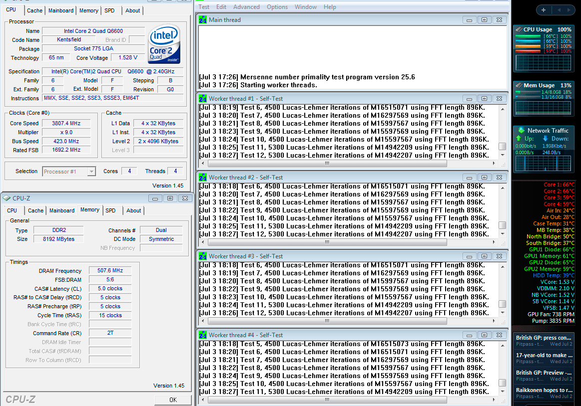

I realised temps were causing a problem for me, my NB was blisteringly hot underload @ 62c and the Southbridge was not much better, so I decided to take the heatsink off while I was refilling and maintaining my water loop. I've never noticed a drastic improvement from replacing stock TIMs on NB's from other boards so was slightly sceptical, but after re-applying with Ceramique I took more than 10c off my NB temps and the SB temps dropped significantly too.:cool:
So, the drops in temps gave me more confidence to get a little more adventurous with the voltages and I've made a little progress here, switched to 5:6 divider and pushed FSB a little further. CPU needs 1.48v for 3.75Ghz prime stabel and ~1.53v to hit 3.8 Prime stable with load temps not exceeding 67c.:up:

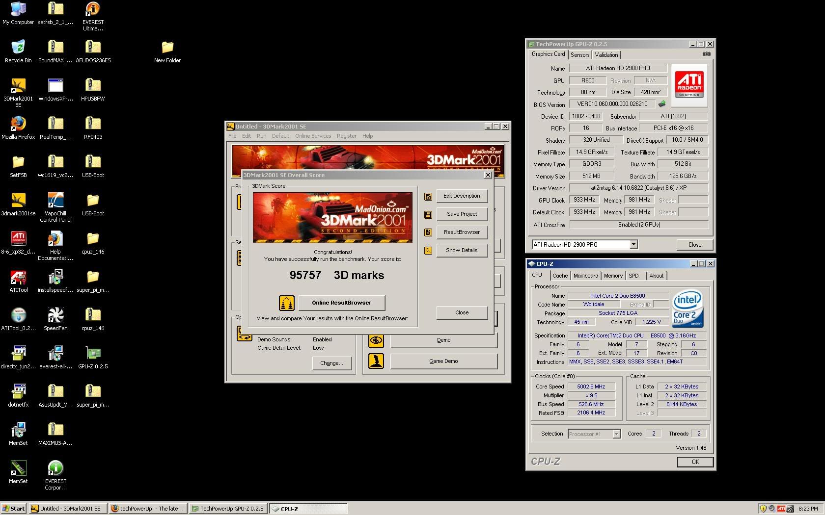

my maximus i can bench @ 5ghz w/ my e8500
http://i48.photobucket.com/albums/f2...2976/95757.jpg
last night's run... zero tweaks. (ram @ auto)
