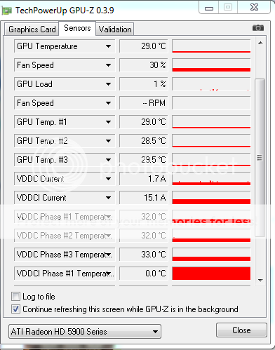

thanks Ijust got in to ati card now ,not a expert in the matter
do you see a issue here?

alright I run furmark xtreme burning test for 10min set gpu-z to high reading
here the pic,the vddc are to hot I guess they are not making good contact with cooler ,which one in the pbc are dose ?
the gpu's temp drop 10c with the new cooling ,how they can be such a huge temp differences ,40c gpu vddc 126c damn:shrug:
http://i284.photobucket.com/albums/l...4/gputemps.png
Those are the VRM temps. You don't want your VRMs at those temps under normal gaming. So I'd run your most stressful game with GPU-Z in the background and see what temps you get. If they are still in the 100-120's, dial back your overclock and/or voltage, cause it will just lead to the card throttling (reducing clocks), or possible damage (parts are probably rated for 125C, but i don't think you really want them constantly at those temps).
yes I understand that at those temps is going to fry my card
so i need help to cool down the vrm's
were in the pcb are these ? mark then in a pic please ,if you didn't askfor this temp check ,I would continue to run oc and probably burn the vrm's thanks for the help :up:
