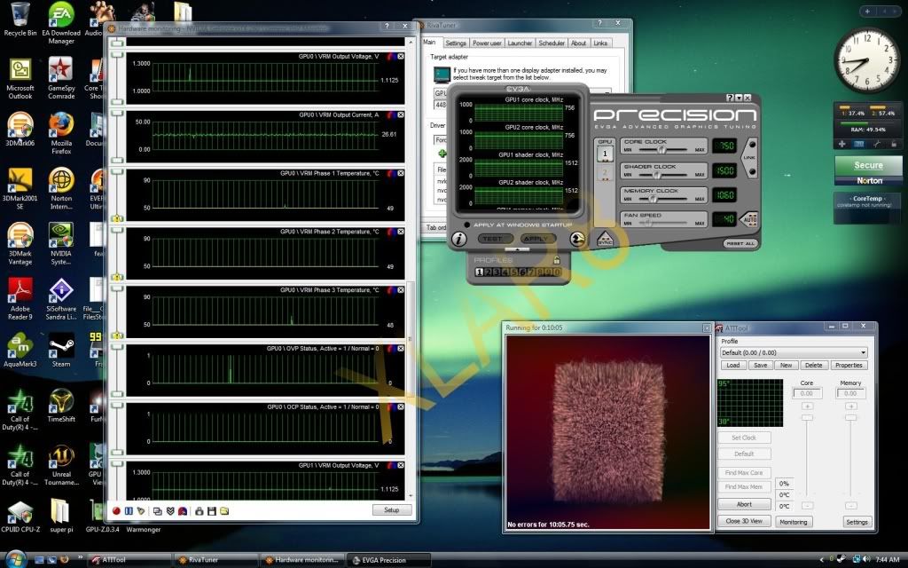

Just did a little testing with two gtx295's
But it will only set to 3 of the cores.
I've taken 3 screenshots that may help.
http://img200.imageshack.us/img200/7...ltagetuner.jpg
