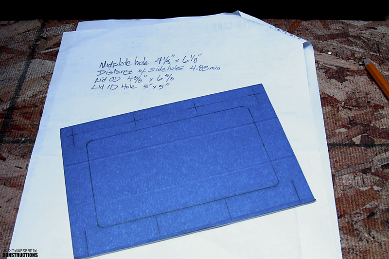

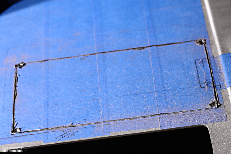

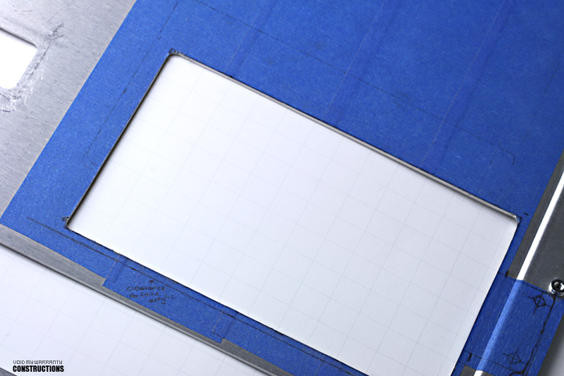

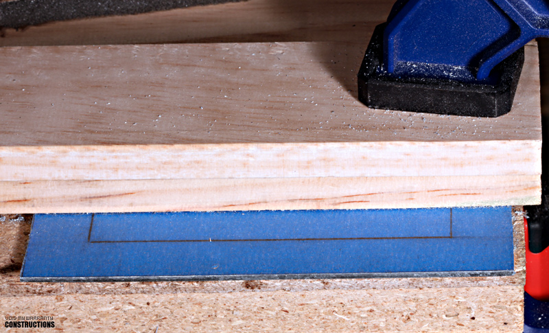

I started off creating the hatchway with a 12"x12" aluminum sheet.
This time my pencil guides weren't so awesome.
Lining up the acrylic to the frame and the screws, while being aligned with the hole in the midplate made the eraser pull some overtime.

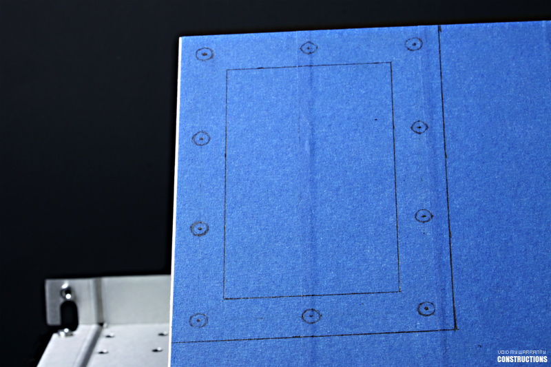

Marked before surgery:
http://lh5.ggpht.com/_QLiEm5wyerY/S6...0/IMG_4992.jpg

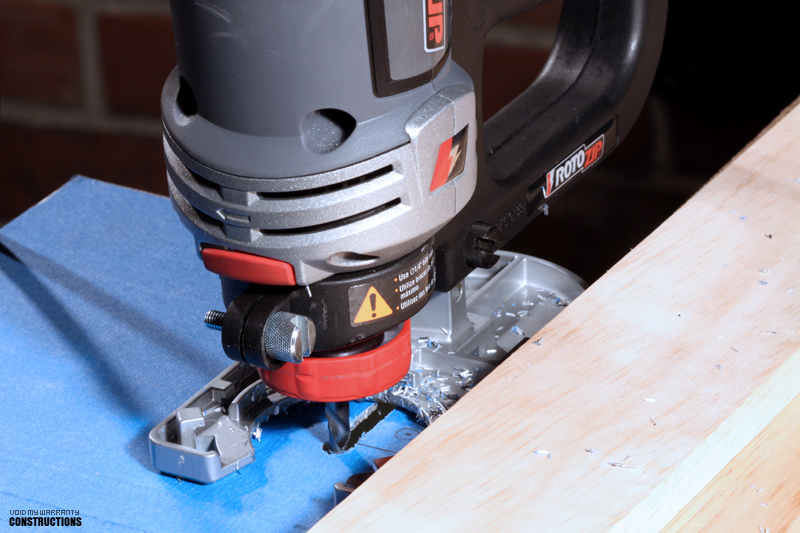

Then I went to town on it using the Rotozip:
http://lh3.ggpht.com/_QLiEm5wyerY/S6...0/IMG_4996.jpg
http://lh6.ggpht.com/_QLiEm5wyerY/S6...0/IMG_5008.jpg
Remeasured, adjusted and remarked:
http://lh3.ggpht.com/_QLiEm5wyerY/S6...0/IMG_5027.jpg
It was also used to cut out the center hole:
http://lh6.ggpht.com/_QLiEm5wyerY/S6...0/IMG_5037.jpg
http://lh6.ggpht.com/_QLiEm5wyerY/S6...0/IMG_5125.jpg

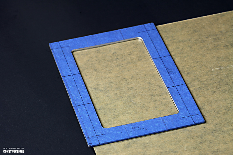

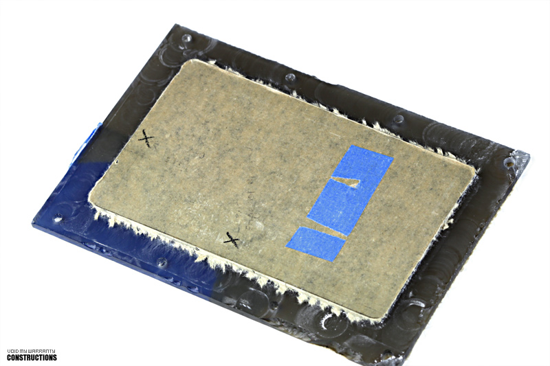

The acrylic piece was routed down to fit flush up against the center hole of the hatchway frame. She shall be polished:
http://lh5.ggpht.com/_QLiEm5wyerY/S6...0/IMG_5219.jpg
Fitted the frame to the acrylic window:
http://lh6.ggpht.com/_QLiEm5wyerY/S6...0/IMG_5225.jpg
She shoots! She fits! She scores! :eleph:

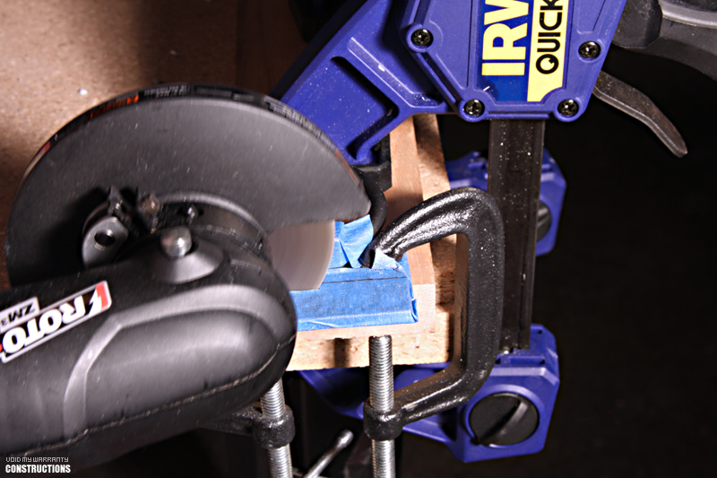

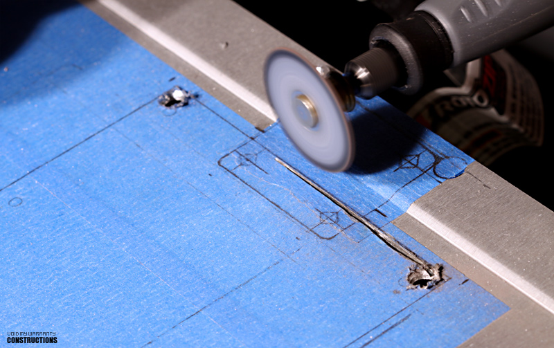

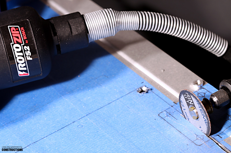

Used up two Dremel cutting wheels on the Rotozip Flex Shaft attachment to cut out the hatchway hole on the midplate:
http://lh6.ggpht.com/_QLiEm5wyerY/S6...0/IMG_5230.jpg
http://lh4.ggpht.com/_QLiEm5wyerY/S6...0/IMG_5231.jpg
Aside from using lubricant to lessen the heat build-up generated by the friction (did I just type, "Aside from using lubricant to lessen the heat build-up generated by the friction"???), I went around the perimeter twice with the cutting wheel.
The first go-round was to create the straight "starter" cuts while being careful not to stray outside the pencil guides.
The second go-round was to actually cut through the aluminum.
http://lh4.ggpht.com/_QLiEm5wyerY/S6...0/IMG_5234.jpg
http://lh5.ggpht.com/_QLiEm5wyerY/S6...0/IMG_5251.jpg

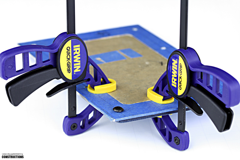

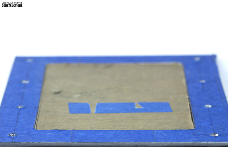

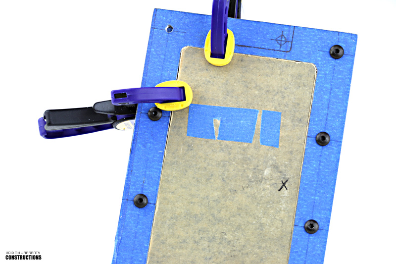

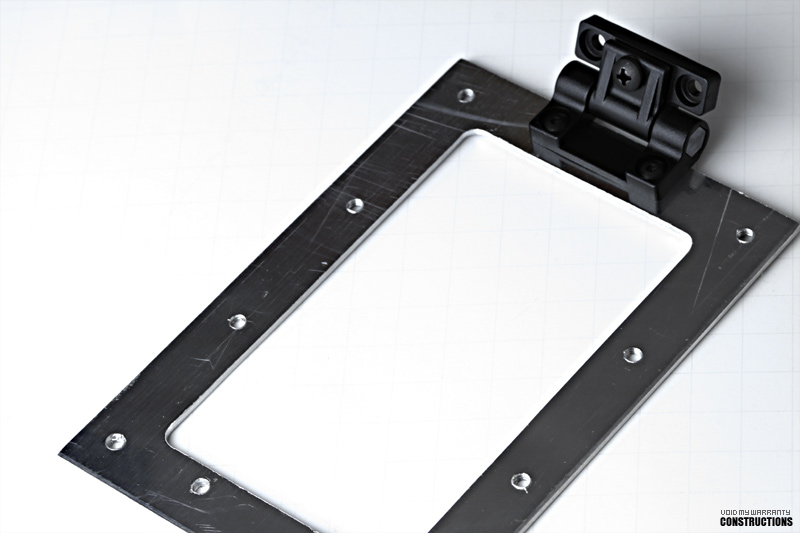

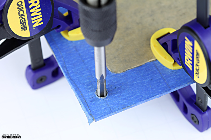

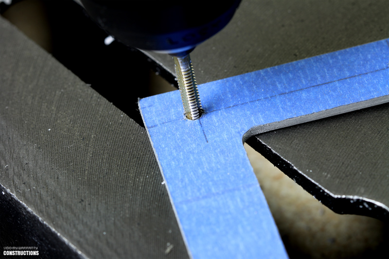

Tapping the alumunimun hatchdoor:
http://lh3.ggpht.com/_QLiEm5wyerY/S6...0/IMG_5182.jpg
http://lh6.ggpht.com/_QLiEm5wyerY/S6...0/IMG_5186.jpg
White knuckled the tapping through the aluminum into the acrylic window attached underneathe.
I used the oompa loompa version of the Irwin clamps:
http://lh3.ggpht.com/_QLiEm5wyerY/S6...0/IMG_5244.jpg

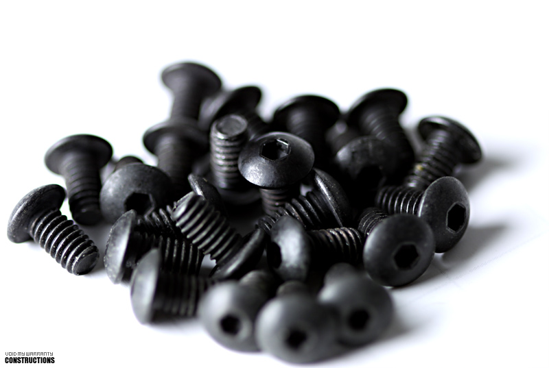

Dressed the hole with screws right after each tap.
To ensure alignment of each hole, I tapped the next hole on an "X" formation (the next tapped hole was the opposite furthest point.)
http://lh4.ggpht.com/_QLiEm5wyerY/S6...0/IMG_5242.jpg
http://lh5.ggpht.com/_QLiEm5wyerY/S6...0/IMG_5246.jpg

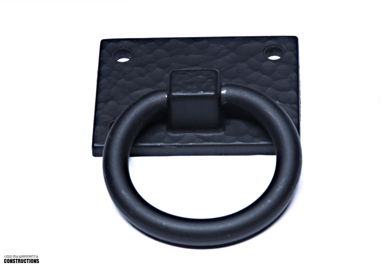

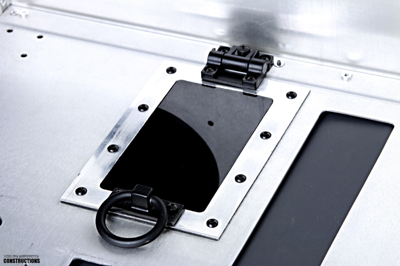

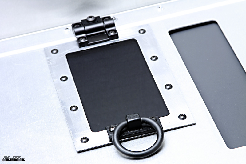

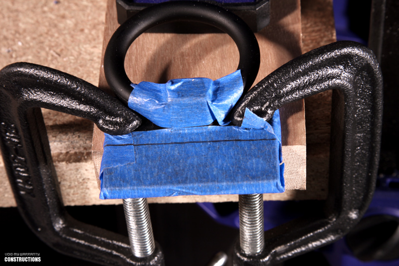

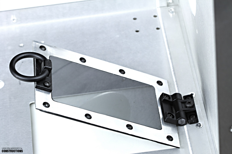

The hatchway handle:
http://lh5.ggpht.com/_QLiEm5wyerY/S6...0/IMG_5018.jpg
Had to cut an inch and a half off to fit the frame:
http://lh3.ggpht.com/_QLiEm5wyerY/S6...0/IMG_5023.jpg
http://lh6.ggpht.com/_QLiEm5wyerY/S6...0/IMG_5026.jpg

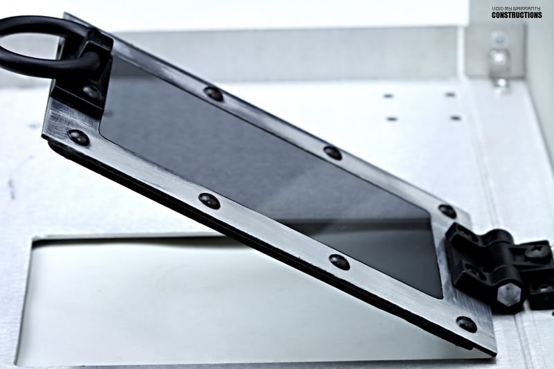

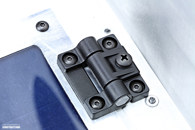

I used a friction hinge.
It sports an "adjustable torque resistance" feature.
The tightness of the adjustment screw dictates the strength of the resistance.
http://lh4.ggpht.com/_QLiEm5wyerY/S6...0/IMG_5258.jpg
This allows the hatchway door to be suspended at various angles.
http://lh6.ggpht.com/_QLiEm5wyerY/S6...0/IMG_5262.jpg
Here is how she's currently looking:
http://lh6.ggpht.com/_QLiEm5wyerY/S6...0/IMG_5264.jpg
http://lh4.ggpht.com/_QLiEm5wyerY/S6...0/IMG_5266.jpg
http://lh3.ggpht.com/_QLiEm5wyerY/S6...0/IMG_5276.jpg
http://lh3.ggpht.com/_QLiEm5wyerY/S6...0/IMG_5273.jpg

I do the roughly the same thing when using a cutting disc, it doesn't matter if I'm using a dremel with a 1" cutting disc a 5" grinder or my 9" grinder to cut, the process is the same. :yepp:
The best way to cut a straight line with a cutting disc is to just let the disc make a shallow groove along the edge of your mark
(on small cuts I do one edge at a time, bigger cuts I may go 1-2' in front) then finish the cut with a second go at it.
Really like the way you have made this hatch, Excellent work mate. :up:
