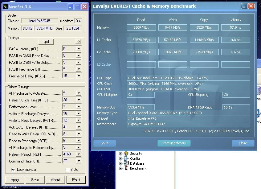

I'll set the trfc to 28, but any lower PL and it won't post.
EDIT: I change that one down to 28, but it didn't help much? I tried lowering some more, but it froze.
Alright I'll give that a go, also with the 5-5-5-15-4-28, what timing is the 4?
Thanks
EDIT: I got PL 7 now :)

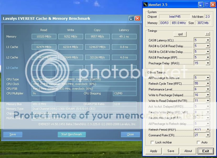

Its just a matter of playing around with your gear. I can run PL7 at 480 FSB / 640 MHz (3:4) without any trouble, and PL6 at 434FSB/651 MHz (2:3).

434 FSB / 651 MHz CL5, PL6, Clock Twister Stronger
http://i720.photobucket.com/albums/w...B651MHzPL6.jpg
