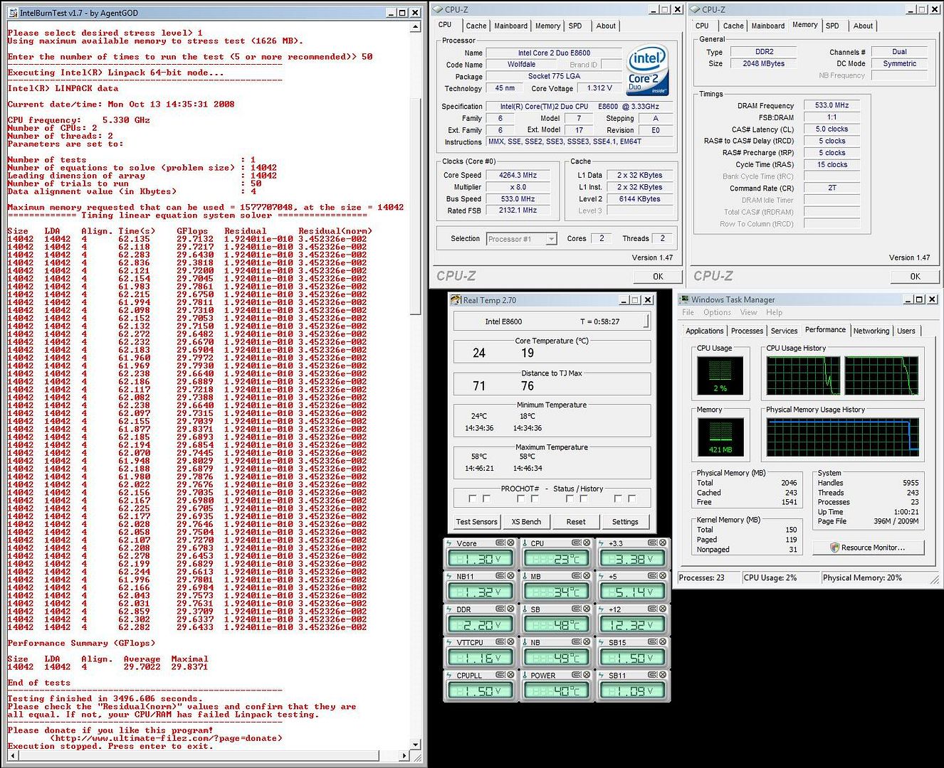

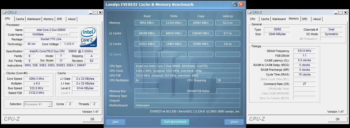

Proc : E8600 @ 4.264ghz 533x8
Mobo : Asus Maximus 2 Formula
Ram : Team Xtreem PC2-6400 CL3's 2x1gb : 5-5-5-15 tRD 10 2.2v
PSU : Silverstone OP1000
OS :Windows Vista Ultimate 64bit
(Setting works for 4x1gb also.. didnt post cause rmaed one stick after running 1066 CL4 tRD 9 2.35v for nearly 2-3 months)
http://i287.photobucket.com/albums/l...ntitled2-1.jpg
http://i287.photobucket.com/albums/l...ntitled-21.jpg
http://i287.photobucket.com/albums/l...ntitled3-1.jpg

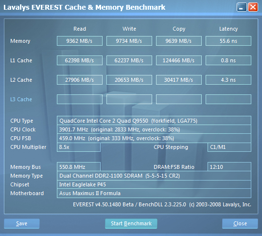

I have a decent setup for F2-8500CL5D
@ Grnfinger , IM getting 8700 read 10067 write and 9500 copy at 475fsb PL10, timings 5-5-5-15, everything else set to auto, thanks.

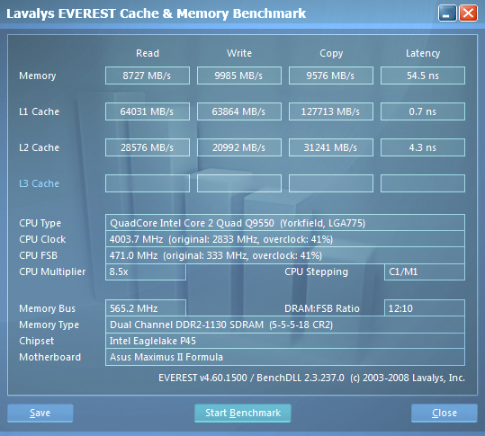

Thats about the best I can do @ 1132MHz
have you tried a lower PL?
I'm running PL8 but my timings are rather relaxed to get them stable
DRAM Frequency: DDR2-1132
Dram Clock Skew CH1 A1 : Advanced 350ps
DRAM Clock Skew CH1 A2 : Normal
Dram Clock Skew CH1 B1 : Advanced 350ps
Dram Clock Skew CH1 B2 : Normal
DRAM Timing Control: Manual
CAS# Latency : 5
RAS# to CAS# Delay : 5
RAS# Precharge : 5
RAS# ActivateTime : 18
RAS# to RAS# Delay : 5
Row Refresh Cycle Time : 65
Write Recovery Time : 6
Read to Precharge Time : 5
Read to Write Delay (S/D) : 10
Write to Read Delay (S) : 4
Write to Read Delay (D) : 5
Read to Read Delay (S) : 6
Read to Read Delay (D) : 6
Write to Write Delay (S) : 5
Write to Write Delay (D) : 6
Write to PRE Delay : 16
Read to PRE Delay : 6
PRE to PRE Delay : 1
ALL PRE to ACT Delay : 6
ALL PRE to REF Delay : 6
Dram Read Training : Disabled
MEM OC Charger : Enabled
Ai Clock Twister : Moderate
Transaction Booster : Manual
Common Performance Level [8]
I do get better bandwidth at 1100 but there is a difference in timing
