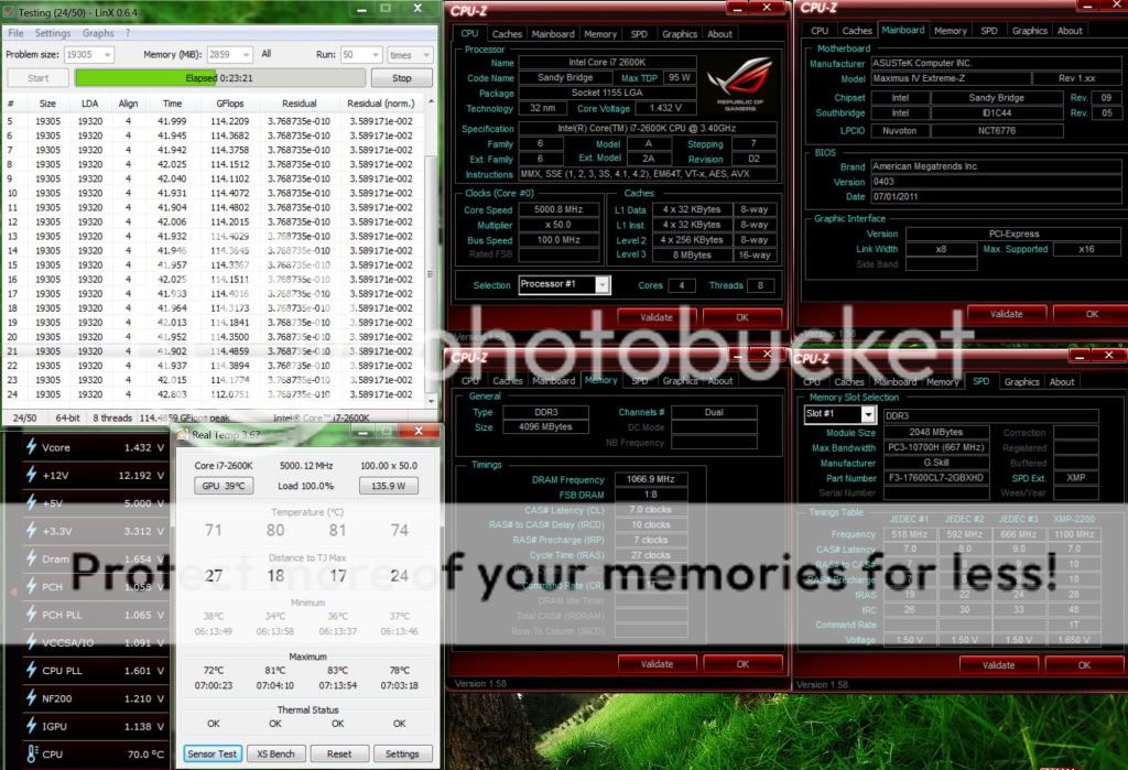

Received my MIVE last week. Installed and work like a charm :) Looks very nice too !
As for now, im running my 2600k 4.5ghz with 1.33v, passed 10x LinX without issue. Ill work for better volts as soon as i can and ill try to reach some good clocks for gaming.
You guyz leave alot of settings on AUTO (like PLL and others ) or you manual alot ?
http://infodupat.com/MIVE_023.JPG
I leave a lot on auto except the Vcore ofcourse. I hit 5Ghz for about 2 hours then said i don't need it and clocked it back to 4.4Ghz.
Thnks Andre !
vcore and temp improved abit with spread spectrum enabled.
http://i458.photobucket.com/albums/q...00K/501442.jpg
