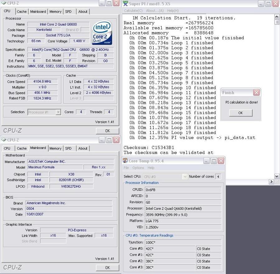

A quick bench and suicide run. Q6600 Go on a P5K Deluxe.
Q6600 GO @ 455x9 (4.1ghzThereabouts:D ) GSkill 6400 GBHZs 1092mhz 4-4-4-13.
http://img225.imageshack.us/img225/8...32m4090gz9.jpg

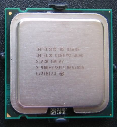

anyone know how good L731 chips are

My G0 under Tuniq Tower. Unfortunately 467 is max FSB for this proc on air :(
http://img.photobucket.com/albums/v2...00L731B163.jpg
