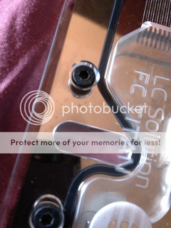

Can anyone tell me what happen to my brand new EK Nickel Plexi purchsed directly from EK Online Store?
http://i458.photobucket.com/albums/q...522-WA0000.jpg
http://i458.photobucket.com/albums/q...522-WA0001.jpg

@owikh: that is not a corrosion as this part is not in contact with water at all. It appears as the nickel plated base was not cleaned properly before the top was installed over it. Not pretty indeed but thats about it. Can you give me the QC number found inside the box so I can forward this to the assembly worker responsible for this?

QC 31 was slapped and (s)he is sorry. Relax, it's a water block, not your cars brake system :p:. Joke aside, these dry spots of residue are always present when the product comes from the nickel plating bath. The products are rinsed afterwards but that never cleans everything. It is a leftover from nickel plating process. That might not be visible to the assembly worker's eye at first glance when we was doing the assembly. Not trying to defend him/her just trying to say they need to do a lot of these per hour just to cover the demand for EK-FC Titan.
