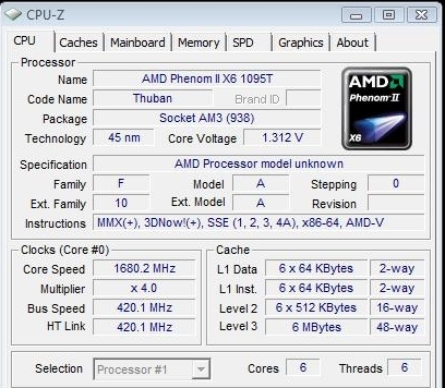

Randi, I work on everything and anything, just stating thuban itself is capable.
420 HT i'm referring to is a boot stable/benchable. I hate that software crap.......it's misleading.
400 HT will give users 1600 ram IIRC with the 800 ram divider. More importantly that equals to a nice 4000 usable NB for the cold guys.
Here's a shot for you that I was booting at.
Everything was eliminated from equasion partly due to using a stock x4 cooler.
http://chew.ln2cooling.com/AMD%20build1/420ht2.jpg
Excellent my man:up:
Thats what I wanted to hear re: that you are booting into Windows at 400+HT. 400HT+ and 1600Mhz Memory+ and 4000Mhz NB will give you guys running LN2 a decided boost at 6000Mhz + CPU speed. With the improved NB where alot of the guys here are at 3200Mhz or a little better, the 400HT and 1600 Mem will also give them a nice boost in bandwidth at moderate overclocks.
I was working with mine this morning at low CPU mhz, but on the Asus CF IV w/ 801 bios anything over 365ish is a no go. I've got the bios here on my laptop to look at right now and tinker with. 400HTT and the 800 divider are important. I tried maintaining 1-2 ratio with 333HT/1333 Mem with tight timings but even with a 3500Mhz NB the system bandwidth was not as high as I last posted in my own thread.
