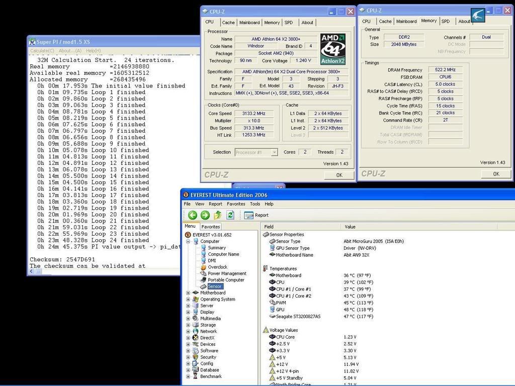

Here's my SS for my OC attempt.
Just started playing with my F3 as was pretty busy before this.
http://i187.photobucket.com/albums/x...angjr/3133.jpg
I have not tried to push it to 3.2Ghz yet, and will validate my CPU-Z when i manage to push this chip to the max.
Currently running 3133@1.20v (Set to 315x10 in cmos), using Team DDR2 667 Value Rams @1044Mhz 5-5-5-12@2.0v.
Stepping is CCB8F 0737 BPMW...
