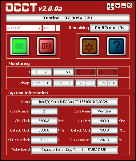

Hey guys. I really want to OC my E8400 to around 3.5 or so Ghz, but don't know squat about OCing. Anyone know where I should start?
specs: CORSAIR 620HX, ASUS P5Q-E, XIGMATEK HDT-S1283
btw- I idle around high 20's according to real temp, and orthos usually puts me around 40 degrees.
thanks a ton for any help!
set the lower Voltages on your motherboard and set your fsb @ 400 Mhz
99% you wont need to do anything more and your cpu will work @ 3600Mhz
use prime small fft's for 5-8hours to see if you are stable

set the Vcore @ 1.25
Vtt @ 1.1
DDR Voltage @ your rams default
the others Auto
boot @ 400 Fsb and you are done

ok guys. i got the new CPU in. my temps are great compared to the old CPU. its not the E0 stepping but im happy.
i put it in fired it up to make sure its running then took it to 3.6ghz. running OCCT now. all's well so far.
i know you want me to take it to 4+ghz..lol i will in a couple days dont wanna toast it before i get to use it any..lol
here is some shots of everest,occt,cpuz.oh yea i have all settings at auto. so i havent done anything to it to get it to run 3.6ghz...
trust me now that i dont have the temps to worry about 4+ghz is on the way. hopefully i can run every day at 4.0ghz thats truely my goal.
under load here

yes core 0 has a stuck sensor when idleing.
so should i rely on core 1 when idleing? can i fix a stuck sensor? or should i RMA this one casue of that and try for a E0???lmao
Maybe its me but around 60c seems hot to me. My E4400 @ 3.4GHz 1.55v has a load temp the same as your E8400 :p I would of thought your CPU would load around 50c tops with that vcore.
