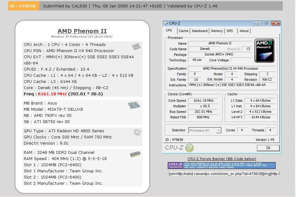

So you guys are still getting very high overclocks with a Phenom II WITHOUT having to rely on ACC right? I'm asking because I just ordered a PII 940BE and Asus M3a79-T mobo with OCZ DDR2-1066.
Yea, enabling ACC results in a no-post for me with it set on Auto.
Worst thing I did was to enable ACC. I changed ACC to AUTO and the damn thing wouldn't even post. I had to clear the CMOS via jumper.:(
I can do 4.0Ghz with 1.6V on water cooling Super Pi 1 Meg stable and windows stable.
Sweet spots are 3.6Ghz at default vCore to 3.8Ghz with 1.45vCore. Yet to do 3.9Ghz run.:ROTF:
