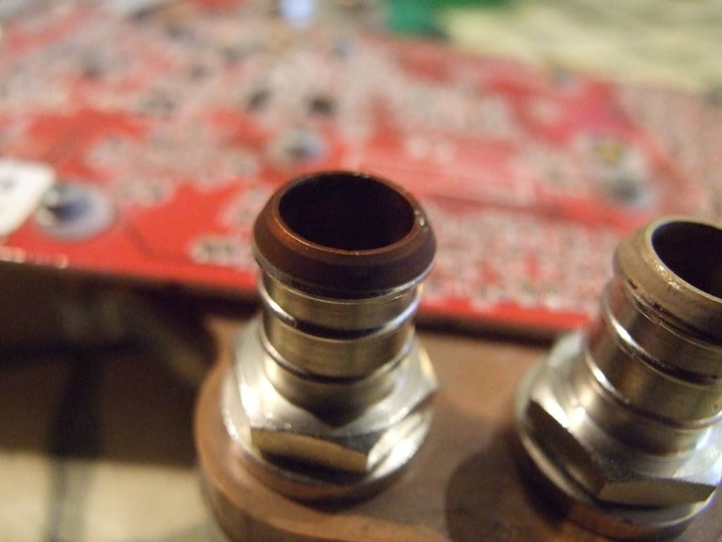

A question for you SNiiPE ... do you know what your water temps were in your reservoir? I know you said your temps were in the 60s, but I assume that was the CPU?

That's exactly the point. I don't know what's in it, but I do know that it's not blocking the light, so rather than conjure up a hypothesis to support my pre-existing viewpoint, I take the safe road.
I specifically used phrases like "take a chance" and "roll the dice" because I don't know for sure.
The point is, I've seen these products used properly and they're fine. I've seen your loop and something went wrong in there. It could have been user error, or it could have been a manufacturing defect, but since we know that you've mixed chemicals in the loop, I'm leaning towards user error on this one.
The reason I would come in here guns blazing is because of the claim you've made in the subject of your post. You can't say stuff like that, man... You haven't confirmed anything, and I've never seen any evidence of an incompatibility between Feser Blue and the APOGEE GTZ. One of my co-workers is running just this configuration (based on my recommendation) and your post had him running home yesterday to check for disaster.
meh.... i went though almost ever variation in coolant.
theres a reason why i push straight distilled. And there was a reason why i made a big deal on us getting silver last year.
? If you read the post I conclude that the constant high temps had to be a major factor in the intense clogging I experienced for this very reason: we dont have mass reports of clogging GTZ's with feser fluid because most people arent using their machines that much.
No other parts of the loop are clogged in crap, all the barbs are clean except the ones on the CPU block so what exactly should I be concluding?

Heat does not cause a reaction. It can only assist it.
And I think you would be surprised to discover that the temperature of the water right next to the copper in the GTZ is within 1 degree of the water anywhere else in your loop.
This is not the cause of your problem.
