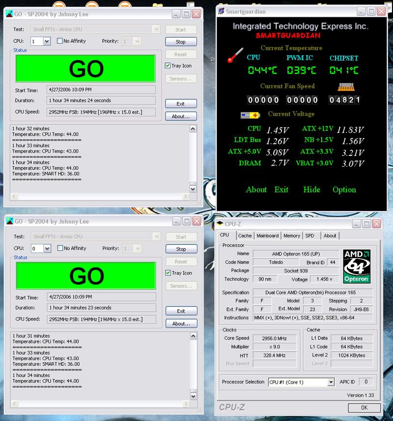

I`m new here, and here my 170 DC result:
3060 MHZ @1,5V
http://img50.imageshack.us/img50/4696/vpmw30608ak.jpg:toast:
cu ballater
user name: DltdApS
model: 165
stepping: CCB1E
date: 0608
packaging: MPMW
stable vcore: 1.475v + 110% / frequency: 3100 / idle 32c / load 41c
cooling: Watercooling in my sig
coldbugged: don't know
http://img259.imageshack.us/img259/7...48mn6wj.th.jpg

got a 170 from Meat Frog today. CCB1E 0550VPMW. Took the lid off already and put it under my Storm block. Its been priming for an hour 2900 1.42v so far. I have tried for 3Ghz but even at 1.55 core 0 failed after a few minutes. Although 3Ghz is not prime stable, im sure 3 or even 3.1Ghz will be benchable.
That's too bad. My core 0 gave me trouble. When I was priming at 2900 at 1.488v, I thought my chances for 3G were slim. Fortunately mine scales pretty well with voltage. Not the best CCB1E 0550VPMW but it goes 2700, 1.3v; 2800, 1.4v; 2900, 1.488v; 3000, 1.5v, 3050, 1.536v, all prime stable. Gonna pop the lid and put under storm. I had to keep the load under 40C for those results. Hopefully that can be accomplished 24/7 with water and no top.:D
interesting.. maybe my vpmw is the same.. seems to follow that pattern.. I was hoping it might scale well at the top end.. I need just about the same vcore to stablize 2.9ghz.. 1.475 + 2.8% (or whatever the lowest v bump addition is). I thought 3ghz was not an option as a result.. but who knows.. maybe it will be? I can only hope. :)
Just remember to keep temps below 42ishC.
I think I have reached the thermal limit with this cooling. Core 0 fails Prime 95 @ 2800Hz in 20 seconds. I am happy with 2700 on air. Can't wait to see what it will do on water in the next couple of weeks.
user name: Crashtack
model: 170
stepping: CCBWE
date: 0609
packaging: FPAW
Vcore: 1.46v
frequency: 2700
idle: 34c
load: 44c
cooling: TT BT + AS5 + IHS on
Prime 95: 13hr + stable
ya, these chips naturally run HOT. With the IHS on i was hitting 47-48C, but now that it is naked it sticks at 38C dual priming... It does idle a few degress higher than my old 0546XMPW too. This one sticks at 31-32C where as my old one was at 28-29C.Quote:

Finally got to pop in my ccbwe 609fpaw and right now its merrily priming away at 2.6 stock volts :D
I've won one of those CCBBE0610DPWM from ebay. Ended a bit hig$ but still cheaper than in Spain :eek: and here I can't know the stepping. The last one I bought for a friend was another CCBWE 0551 UPMW :(
Next tuesday I'll post my results (if it arrives). I just want something cooler @ 2700/2800 and benchable at 3ghz :D (see sig for current 165)
here is a cpu-z verified of my CCB1E 0609FPAW
Cpu-Z verified
i doubt it will be stable, but im going to try some benches.
1.55v in case you were wondering :)
This chip scares me!
OMG...
http://img139.imageshack.us/img139/1215/28805qv.th.jpg
Originally Posted by ChkDsk
is that yours? what stepping? and what cooling areyou using?
Yup, thats mine... It's an 165, IHS on, watercooled (still not upgraded so: Asetek Antarctica CPU block, Hydor L30, Blackice Xtreme 3, and Asetek VGA block on X1900). After 1hr clockgenned to 2900MHz... 45mins so far on freaking stock volts! :woot:Quote:
Originally Posted by itznfb
Oh you wanna know the stepping? 0610DPMW...
sexy
Best I've seen from that stepping :woot:
that's better than both of mine, one of which did 2844@stock and the one I'm testing now which is gonna do ~2826-2835
This thing is freaking me out! Clockgenned to 2900 after 1hr shot... Still going!
Memory is quite at its limits now...
http://img138.imageshack.us/img138/1958/290024is.th.jpg

CCBBE 0610DPMW on watercooling
http://img.photobucket.com/albums/v7...l/93c3e665.jpg
Hmz,... Thats way worse than my results (see post above yours). What watercooling do you have?Quote:
Ow oops, its in your sig.
PWM IC temp is good though, how do you cool it?
Worse than your results, do you have a CCBBE 0610DPMW, where's the screenshot
I run an 80mm fan over my PWMIC it helps a LOT

On the previous page... Up to 2950 @ stock. But I think my motherboard is being an ass to me @ high HTT now. 3105@1.5 failed in 15mins....
2.9 GHz on 1.33v, better than my chip, nice
