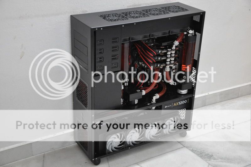

This 3770K batch L220B196 is my best chip I've owned many pcs before all of them needs 1.5v+ for 5GHz.
My water cooling gears are HF + D5 EK Top + EK X2 250 Res | EK FC7970 | 2x RX360 + 12x GT
Ambient is hot here 35C sigh
Thanks for the info man. I've been trying to find what it takes to get 5G 4c 8t on my chip but even 1.44V isn't cutting it for Cinebench 11.5 Cinebench 11.5 is a very fast method to determine stability and it's an absolute sucker for volts. I can run prime for an hour and even have CB 11.5 fail on me.
That is a pretty hefty watercooling setup you have there, i hope you don't have 12x GT 1850 rpm's at full speed running? If you have it will be noisy i guess. I am running a feser 480 with 4x GT 1450, the case is on top of my desk so the fans are pretty close to my ears and even 4x 1450's at full throttle are far from quite.

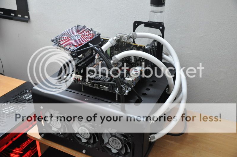

http://i458.photobucket.com/albums/q...DSC_0459-1.jpg
Nice rig man. Why did you remove the pic of the benchtable? I liked that one too.
Do you prefer Prime over LinX? I think LinX makes the cpu run even hotter but maybe i'm still using an outdated version of Prime?
this pic is outdated because it was taken on a Arqtik quad TEC. The TEC is broken & it's under RMA right now so using back my trusty HF.
