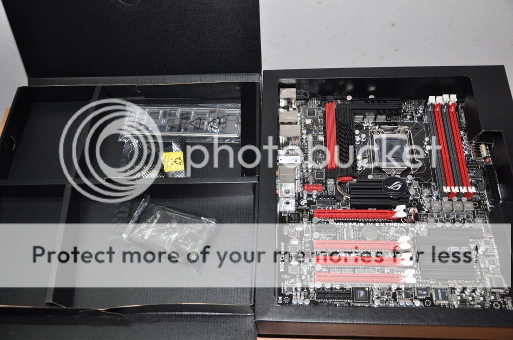

Just got this beast. Anyone know the diff between the 82583 and the 82579 Intel Lan controllers?

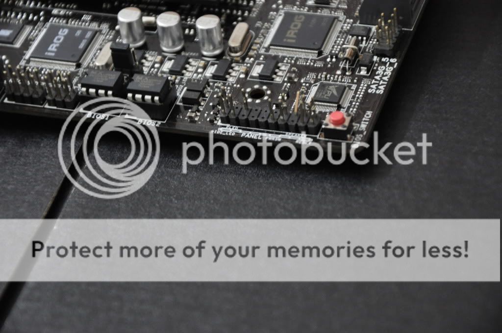

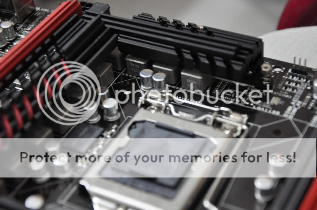

Guys, should i reject this board? I sent my B2 for B3 swap but it came back like this...
http://i458.photobucket.com/albums/q...K/DSC_0025.jpghttp://i458.photobucket.com/albums/q...K/DSC_0030.jpg
http://i458.photobucket.com/albums/q...K/DSC_0032.jpg
http://i458.photobucket.com/albums/q...K/DSC_0034.jpg
so basically Asus just desolders the old B2 chipset and resolder B3 on old board, forget about scratch here and there, missing accessories and return it to customers. Is this the so-called B3 one to one exchange program?

REJECT that damaged board immediately! demand a NEW one!!
So i am not alone with revived board. I duno whether it is DOA or not just don't wanna touch it.
yes of course I will do that, because this is a FLAWED one to one swap program committed by ASSus. They are supposed to give me a BRAND NEW board without question asked.
what a bad first impression u had there man. :(
ASSus will do anything as long as there has a business for them. They never care about their customer feeling instead only concentrate on doing sales. The "desoldering-resoldering" B3 chipset took 3 weeks + which shows they are slowpoke and inefficient in handling such an after sales service. Bottom-notch service :down:
3 weeks +... they gotta stock some well used B2 boards first to start shipping them back as a B3 boards you know, ha-ha
makes me glad I bought a bnib b3 with no problems:D
I would definitely return those turd looking boards asap and demand a bnib product just like you bought originally.

The condition of that RMA exchanged board is kind of "bogus"!!
I guess the best way to ensure a new board is to do an RMA/exchange with the original retailer. It so happened that B3's were already out when I purchased mine but I still have a dead TP67XE that I'm waiting to exchange at Micro Center when ever they get the B3 versions back in stock.
I also have a perfectly functioning B2 ASRock Pro Fat that I bought second hand on the classifieds and the only way to get a B3 is to RMA direct with ASRock. Now I'm wondering what kind/condition board I'll end up with when (if) I RMA it?
