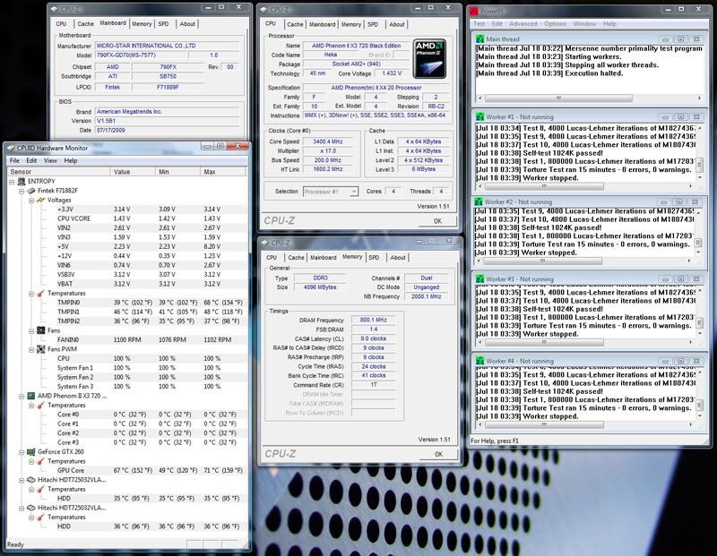

Finally my 4th core from my X3 720BE is now stable..!!
Kudos to the person who made the 1.51B BIOS!!!
Now gonna see how far this chip can go...
http://i23.photobucket.com/albums/b3...4/Untitled.jpg
Three hours blend stable at stock clocks and volts. Next up how low can she go.

9 hours blend completed :hehe:
http://img36.imageshack.us/img36/923...d4core3000.jpg
