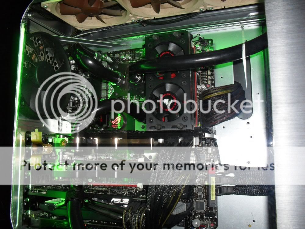

http://i696.photobucket.com/albums/v...ek/gtgreen.jpg
Still unsure what to do ... any other suggestions would be appreciated.

Finally had time to move parts around so that that I have the reIII/980x water cooled, nice to see those lowww temps. Using the EK FC block so the nb/sb temps are staying around 35c at full load.
Oh and don't forget to install that BT board before you install the mobo, cause she ain't fitting in after the fact :lol:
