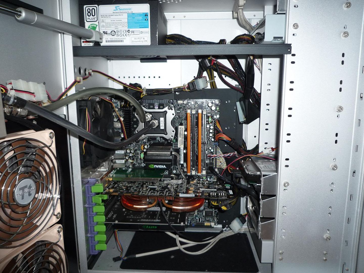

In my case, it was required. This case wasn't designed for such large radiators so I had to work around it. To cool both the graphics card and processor (both have high heat output), I'd need at least 2 X 120mm radiators. But only a single 120mm could be inside the case as the second one would interfere with the full cover block. Not just any slim one either. I had to get a highly efficient one. But the size of an efficient one required the use elbows to divert the inlet and outlet around the large radiator. I'd rather got with normal compressions too. but when you're working in such a case, despite its size, it was never meant for such large rads.
This was the built in cofig previously:
http://img.photobucket.com/albums/v1.../P1000027s.jpg
http://img.photobucket.com/albums/v1.../P1000028s.jpg
I couldn't liquid cool my card with that built in rad. The case door simply wouldn't close if there was a FC block on.
It's not because of poor planning. I planned this loop for months, measuring and re measuring the dimensions.
