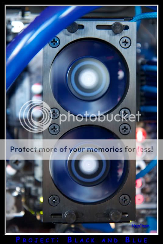

These RAM fans are loud at full speed!! I throttled them back to 40% and it is much much quieter!

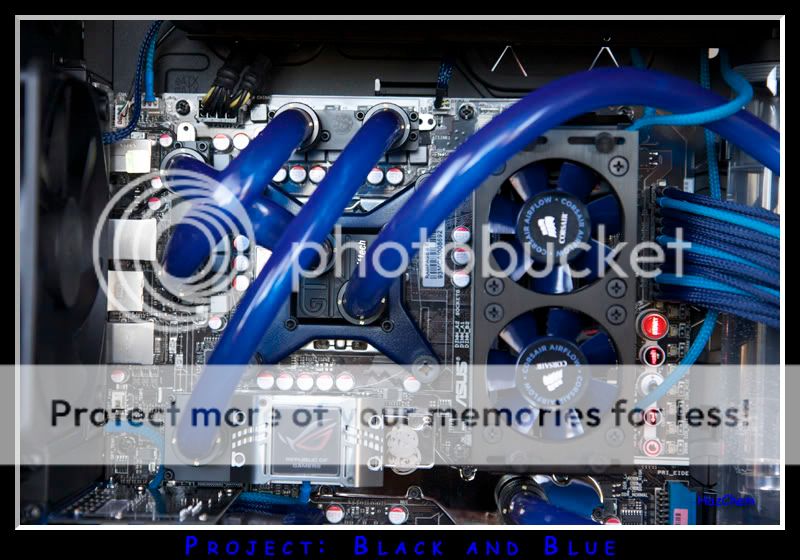

Observant Xtremers will notice that the CPU power cable is not sleeved. :( I miscalculated how much sleeving this beast required! No worries, there's a package from Nils on its way!! This will be fixed in Phase II. :p

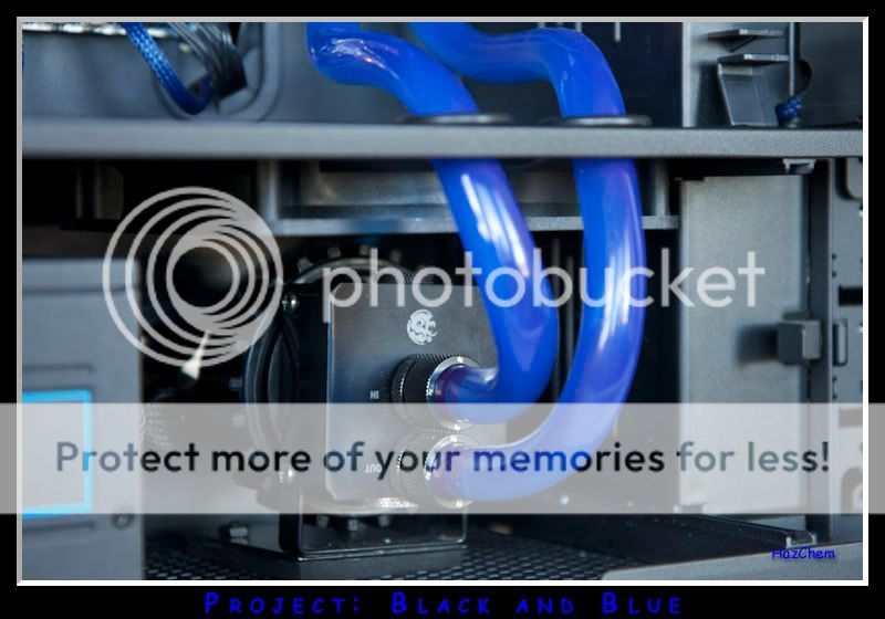

- Moving the pump. I don't like how it's hidden!
- Repositioning some of the tubing for a cleaner look. Specifically from the rad to the CPU and in and out of the reservoir.
