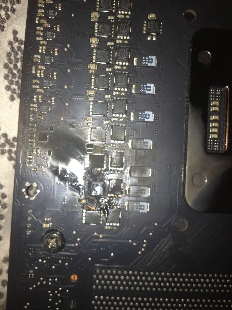

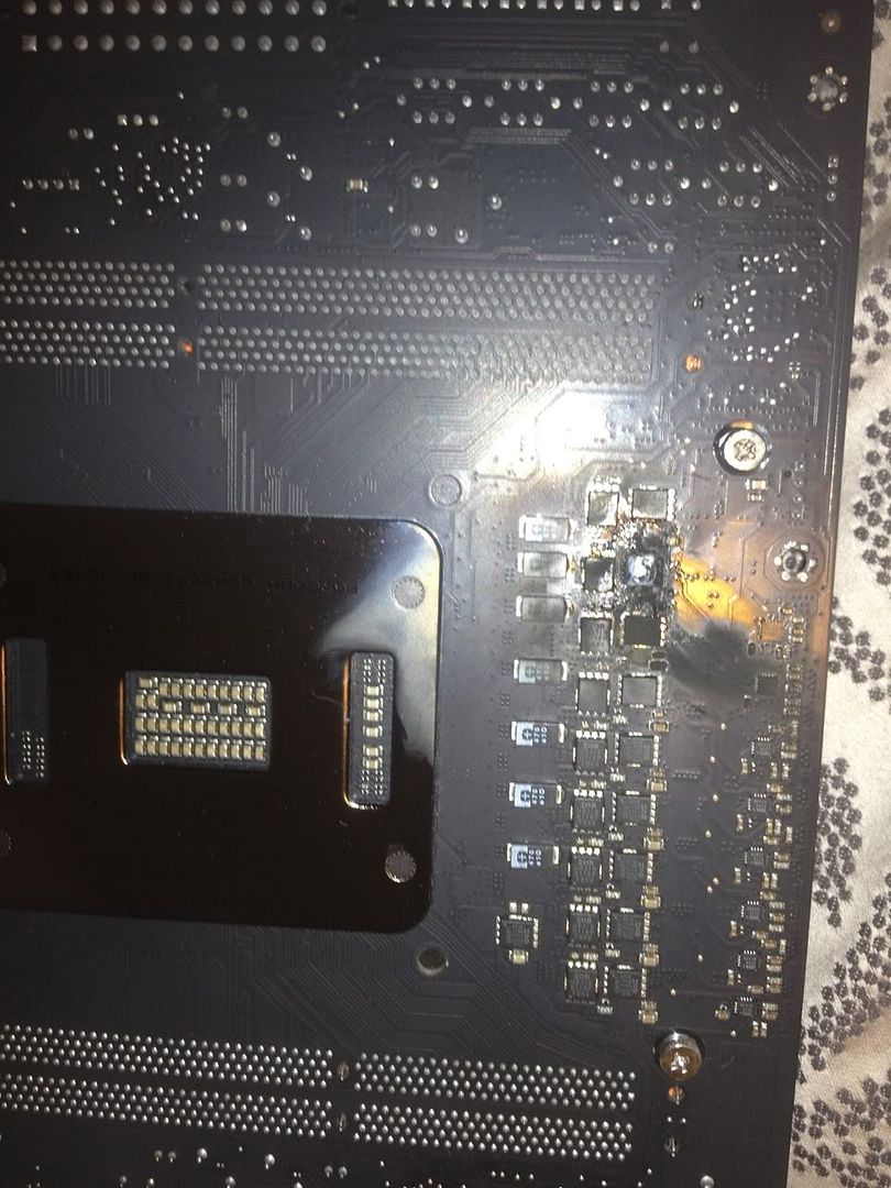

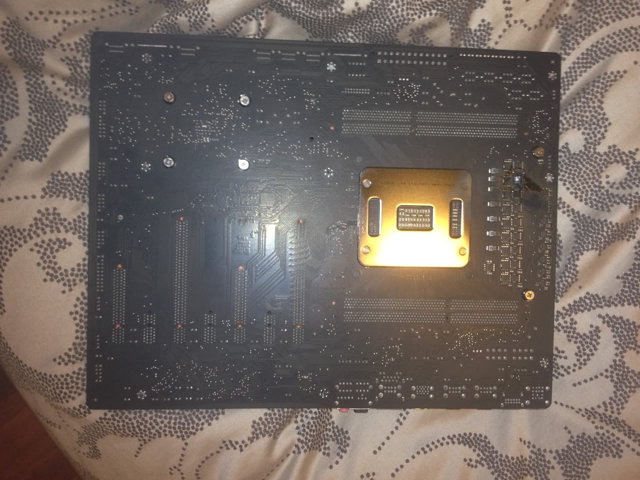

hi guys, i have been following extreme systems forum for a long time and think it is a great forum with a wealth of knowledge, have never posted in the past as i feel a bit of a noob!
unfortunately though i like to let you guys know that my x79-ud7 board burnt out :( it seems smoke came from the similar place as that you tube video of the (Gigabyte GA-X79-UD3 burns)
bios settings were set at optimised settings, i have sent gigabye technical support a email and asking that i will be requesting for my money back! i was getting the 6a error from the word go
and could only post with ratio change in OS disabled, and bios version f7!
Do you remember the BIOS version you had on your system when your mosfets burned out?
It happend to the UD-7 of a friend of mine a few weeks ago but he had an old BIOS version running.

@grafic harbour,
It's bit difficult to explain in in English; the cause for the burning mosfets wasn't the BIOS version by itself. The phase control and firmware of the mosfets failed to manage the overclocking protection. The BIOS F7 was supposed to update the BIOS and the firmware of the mosfet controllers as well.
thanks for your response and time Fritz_the_germ, but this is the first time this has happened to me and i really hope gigabyte just refunds my money without any troubles as that is all i want, i only had the
board for a few weeks! i strongly feel that is my right!
I think Gigabyte won't argue to pay back your money. It was definitely their fault.
You have deserved an extra gift for the trouble you went through

This is what happened to my ud7 last night, i have been running the f8 bios for 1 day before this happened, just sitting in windows also no stress on the motherboard.
http://i206.photobucket.com/albums/b...p/IMG_0476.jpg
http://i206.photobucket.com/albums/b...p/IMG_0477.jpg
http://i206.photobucket.com/albums/b...p/IMG_0478.jpg

But why are so many of these boards frying in the same place? I mean, just IDLE on the desktop? What's going on ....?
the protection mechanism implemented on UD7 may not be functioning correctly. We are getting all these boards back to HQ for testing and will find out what is up and update. It's being treated as a top priority!
