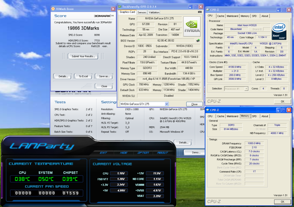

http://i317.photobucket.com/albums/m.../GTX275700.png
Isn't it just nice? :p:
Sorry didn't tried that...but it should be very hot.
I'm in water actually but still everything in default shows 40C in idle and 60ish in load temps...2.8Ghz

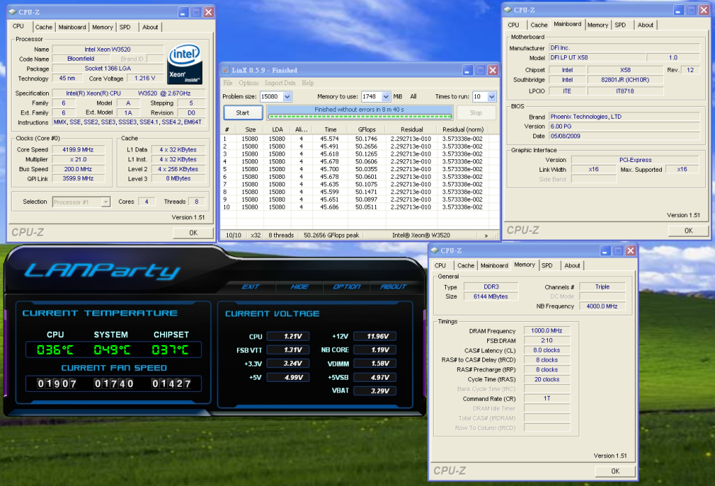

w3520 @4.18GHZ(220 x19), 1.2v , 1 hour primestable
http://img189.imageshack.us/img189/6...ft1hour.th.jpg
I have to test more before i go further with this setup. I don't know how my GTX 295 would react to BCLK 220. So far so good and if this setup "behaves", i may use this for 24/7.

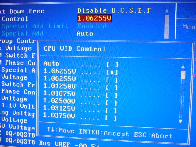

What the hell is this?!
http://i317.photobucket.com/albums/m...8/P1070092.jpg

Is an acid smell normal on dfi when starting it up? I haven't used a dfi since the RD600 days.
He's questioning the screwy order/double appearance of the 1.06255V entry.

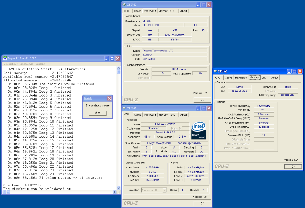

A Quick Test.
This XEON simply ROCKZ!~
http://i317.photobucket.com/albums/m.../X58/35201.png
