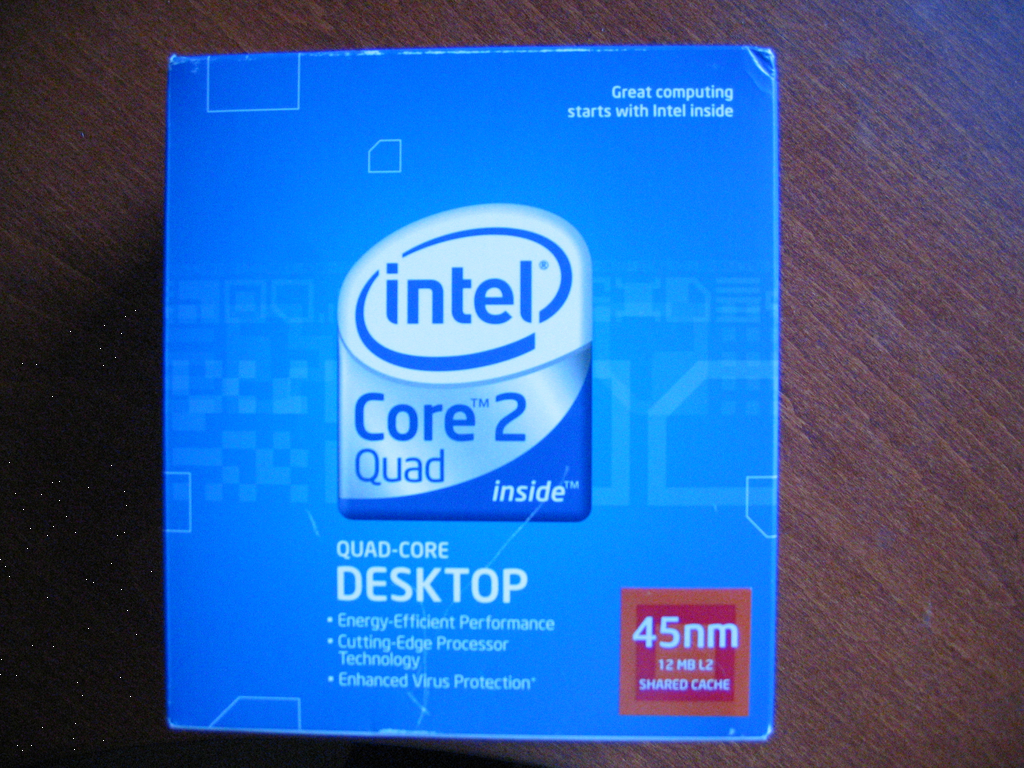

Just got mine. Will be about two weeks before I can get some hard numbers up, though, waiting on my RAM.
http://i165.photobucket.com/albums/u...d/Q9450005.png
http://i165.photobucket.com/albums/u...d/Q9450006.png
http://i165.photobucket.com/albums/u...d/Q9450007.png
