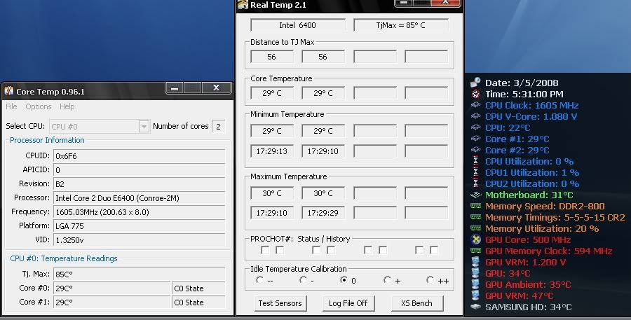

Q6600 @ 8x333 gives a tjmax of 85c.. I read your post here but don't understand why you'd give a b3 stepping a tjmax of 85?
http://img106.imageshack.us/img106/1160/realtempey8.gif
Room temp is 16.1 °C for this screenshot (I drop the heat down to 61 °F at night in my house).
I found out that if I clicked on the "TjMax=85" it switched to 0x6F7 which according to processorfinder.intel.com is right for my chip.
http://img84.imageshack.us/img84/4022/realtemp2cu2.gif
Update: I figured it out... you're using two different TjMax values - one of which is incorrect. The one used to calculate the "core temp" is wrong @ 85:
http://img84.imageshack.us/img84/9048/oosp2od0.gif
...but the one used to calculate the "distance from TjMax" is correct:
http://img84.imageshack.us/img84/8352/oopsmq9.gif

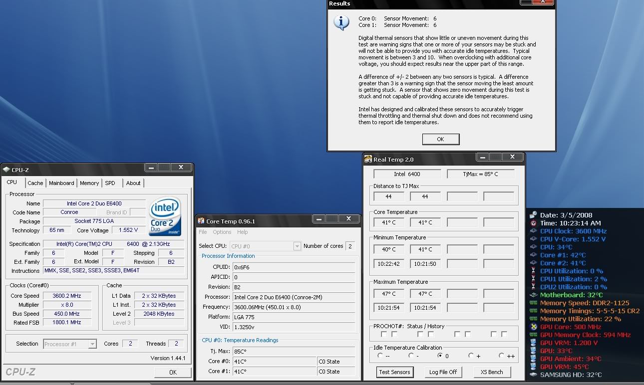

For my well tested E6400 this is what I found:
3200 MHz --- DTS = 5 --- 80C
3400 MHz --- DTS = 15 --- 70C
3600 MHz --- DTS = 25 --- 60C
It was a pretty clear relationship. At 3200 MHz my computer was Prime stable at an absolute core temperature of 80C. I could even go higher and have it start throttling but it wouldn't stop or crash. To get more MHz I needed more core voltage and I had to keep adding more temperature headroom to remain Prime stable. Maybe I'll throw my E6400 back in tomorrow for some high temp abuse!

Seems it's working on Vista X64 SP1 with the compiled drivers posted by WoZZeR999.
I attached two screenshots: first is on XP with RealTemp v.1.0 and the second is on Vista X64 with RealTemp v.2.1 modified.
Note: You must run it as administrator.
:up:

I thought I'd take a day off and do some high temperature testing. No use including features in software if you don't take the time to test them out.
I swapped in my E6400 for a couple of trips up to TjMax and a little beyond. :)
Other software I have used (CoreTemp, SpeedFan) have a problem when you go beyond TjMax but I'm happy to report that RealTemp was the first program I've used under extreme circumstances that didn't choke. Here's the results:
http://img134.imageshack.us/img134/9...emptestmz3.png
Intel certainly doesn't support this but in testing I've noticed that the DTS simply wraps around when it reaches TjMax and begins counting down again from 127. Knowing this I built in some code to convert these readings into absolute temps that make sense. The log file is nice and smooth. SpeedFan and TAT will start to display minus 42C when this happens.
The little check marks lit up just as they were designed to do. When temperatures returned to normal, the history bit remained lit up.
http://img526.imageshack.us/img526/7531/rtidlead3.png
Even restarting the program will not clear the history bit. You need to restart your computer. This is an excellent feature. Even if you don't have RealTemp running you can start it up after a throttling incident and it will display the history of it by showing a check mark in the right hand column for each core.
It's also possible that only one of your cores throttles like this.
http://img221.imageshack.us/img221/6560/prochot1rl4.png
On this E6400 this happens just before DTS=0. Your results may vary.
