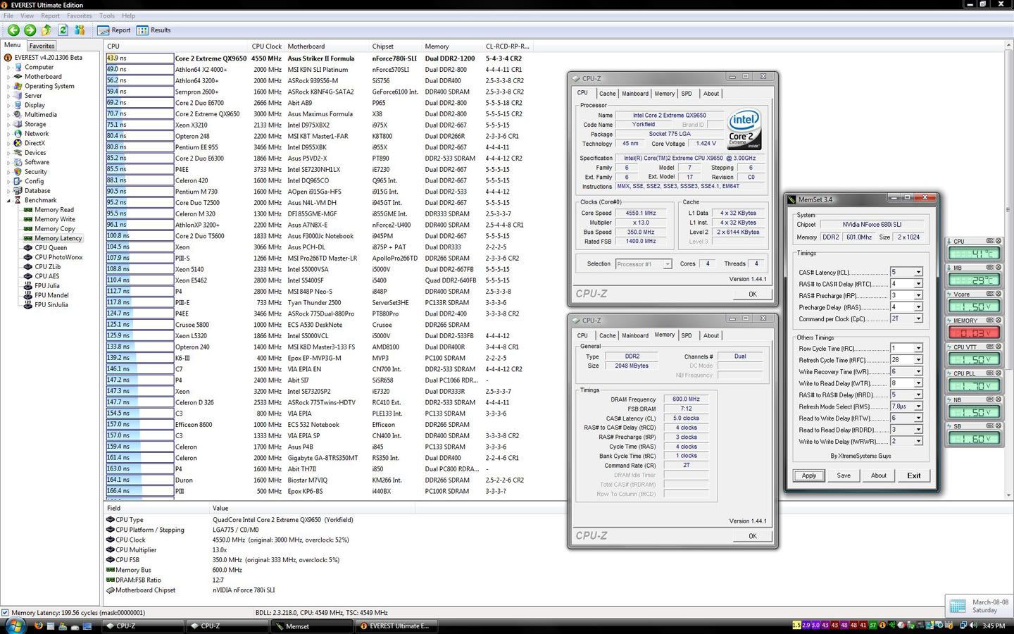

Just remember to get the latest update from the lavalys website. Before the update everest did not recommend my Maximus Extreme / Striker II boards.
(screenshot above is with the Max Ex)

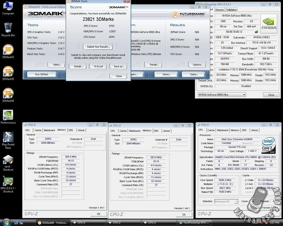

My result with QX9650 n Vapo.
http://i271.photobucket.com/albums/j...GHz5_final.jpg
My problem now :( can't OC three 8800U at the same time, all my setting for fan speed or clock have just apply for second 8800U. Only use Ntune.
Prettty good score as the Ultra is running stock speeds, I got about the same score with an eVGA 780i with 8800GTS 512 in SLI under XP and QX9650 at 4.5 (450 x10) with ram at 1200mhz... I ran stock WHQL drivers... too bad I didn't have more time to mess with the 780i... as I later found out that 169.21 is prety sucky in SLI lol... with some more optimising you can breach 24.5K easily...
