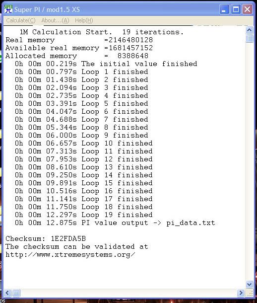

Can someone with a E8400 at 3.6GHz post your 1meg SuperPI score?
Thanks
http://i11.photobucket.com/albums/a1...a_SuperPI1.jpg
Looks like the Maximus Formula offers a little bit of performance at 5-5-5-15 (3:4).
