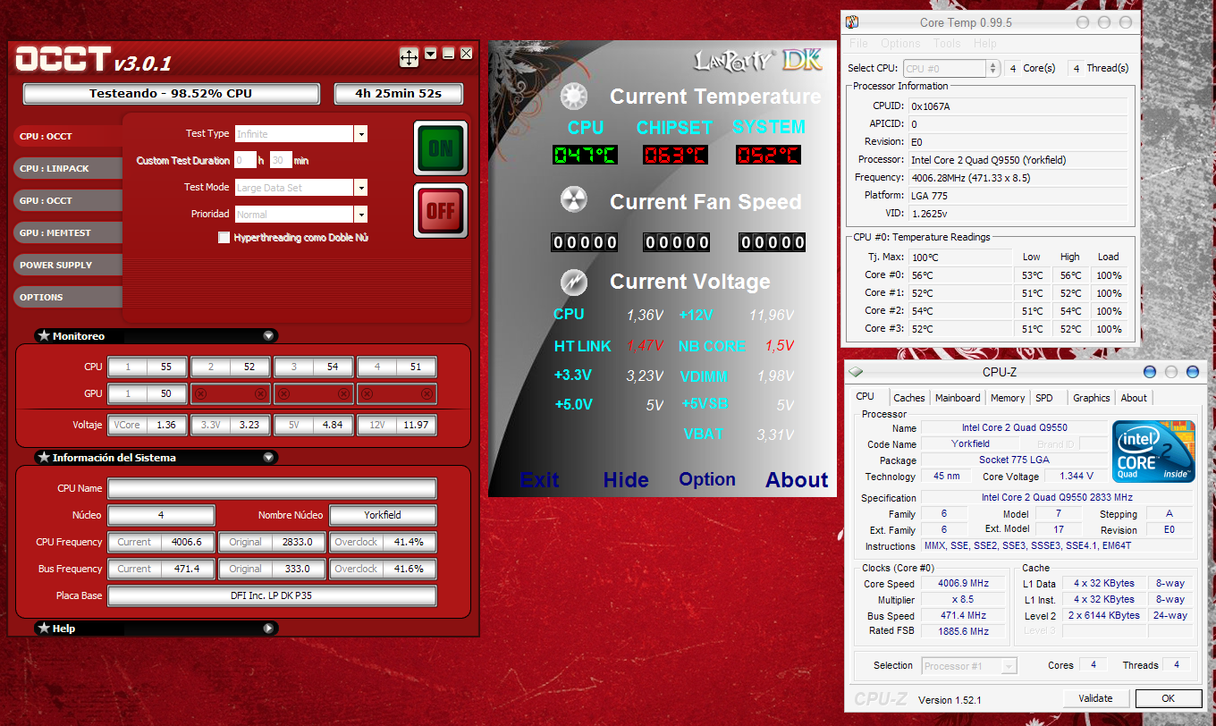

still testing...
I think the temperature is good, when i bought it i expected around 60-70º at 4Ghz :yepp:
Q9550 E0 L844C062
DFI LanParty P35 Dark
TRUE lapped & 2x1000rpms (around 22º of ambient temp)
471x8,5 (4Ghz)
vcore 1.33v (@ full)
NB 1.50v
VTT 1.47v
GTL 0/2 0.61v
GTL 1/3 0.61v
NB GTL 0.67
OCCT 30mins test LARGE DATA SET
http://i770.photobucket.com/albums/x...unreal/534.jpg
I need to lower the vcore till gets stable.
I confused about GTLs and NB/VTT (when i have E4300 and E5400 i let these on AUTO :p:) so im trying all the posible values... :rolleyes:
PD: i have paid 105€ (shipping included) for it, and im waiting another one for the same price....

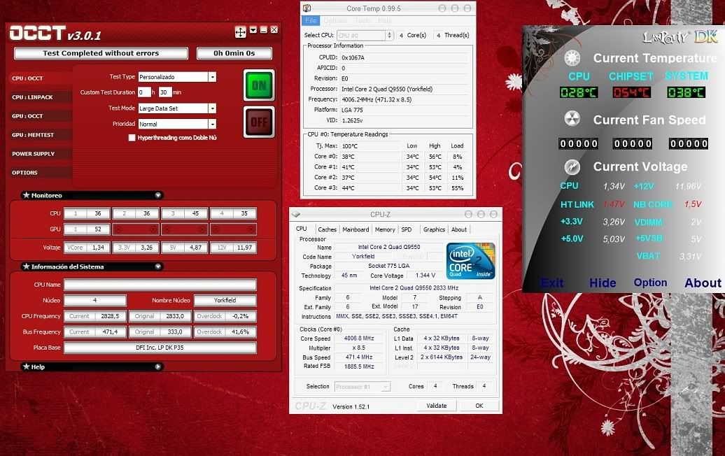

4.25H Stable (i stopped the test)
Q9550 E0 L844C062
471x8,5 (4Ghz)
Vcore 1.34v (@ full)
NB 1.50v
VTT 1.47
CPU GTL 0/2 0,61
CPU GTL 1/3 0,61
NB GTL 0,67
http://i770.photobucket.com/albums/x...eal/423423.png
Still testing...

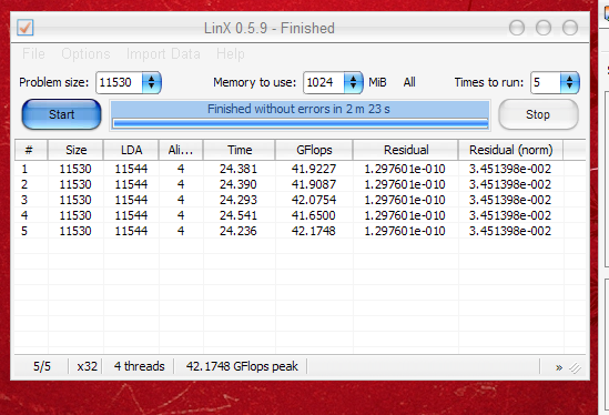

@Unrealer
my chip do 20 loops of Linx at lower voltages,but Prime95 have a error at 5min.Try Prime too.
If you can see what the GFlops that your CPU is putting out with Linx, or use Intelburntest which I know you can see the GFLops the CPU is pushing in that program "I just haven't used Linx mind you". You will be able to probably see that your FSB Term is set to low and your GFlops being put out by the CPU when cold or when it has been shut down all night or all day, are probably half of what they should be with your chip.
I am pushing 58.5 GFlops with my CPU @ 490 x 8.5 @ 1.296v under load, this is with utilizing 3084MBs of my Ram~ for the test and the test finish in around 86s a piece~. I had noticed this because when booting my system cold from being shut down all day or all night, I noticed that when running Intelburntest the GFlops being put out by my CPU were half of what they are when the system has been warmed up or after being rebooted a few times because of me tweaking settings. You can also use it to fine tune your GTL settings as well.
I noticed that if the GTLs are off then two of the cores on the CPU will get hotter then the other two while running Intelburntest or all cores will not get hot enough. This can significantly cut time you spend tweaking these settings because you don't have to finish the test you can just go ahead and stop the test reboot and tweak some more until you see the temps are even and about the right temperature under load taking in to consideration your cooling ofcourse.
Then once you think you have the cores hitting good temps and evenly for that matter, let the test finish and see what the GFlops being pushed out are and if the time finished is fast enough as well. If you get everything set just right BIOS setting wise, all cores will stay about the same temperature all the way through the test nice and stable like. I just caught on to this and was able to tweak mine to perfection landing me the following.

Your FSB Term is set to low, or Intelburntest is better optimized one of the two. I would look into that. Look at my numbers compared to yours. There shouldn't be that big of a difference in speed between me and you. Your CPU can be stable and still not be performing the way it should be. Bump up your FSB Term and fine tune your CPU GTL and test again and I bet it goes up. Not only that, your system will act alot more responsive once you hit the right FSB Term voltage for what speed you are at.
Edit: Sorry I just noticed that I didn't post a pic of my testing with Intelburntest but, I am hitting 58.5 GFlops compared to your 42 and we are pretty close speed wise. I think you should be hitting 55 GFlops.

Ok but, that was not that big of a difference though right? Like a tiny difference there compared to the 10GFlops I am thinking he is losing. Thank you for checking by the way. Not only that but, going from 470ish to the 490 I am sitting at now I think increased it only by 2 at the most I beleive.
Do you mean VTT? what value should i use then?
And im confused about GTLs, i tried 0,67 (on both) and it was stable during 2mins, i tried 0,63 and it was stable during 8mins.... i tried with 0,61 (also on both) and is OCCT stable for 5 hours or more (i stopped the test).
The last value i need to test is 0,57 and i also need to test North Bridge GTL, cause i let it default (0,67).
