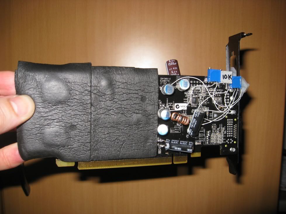

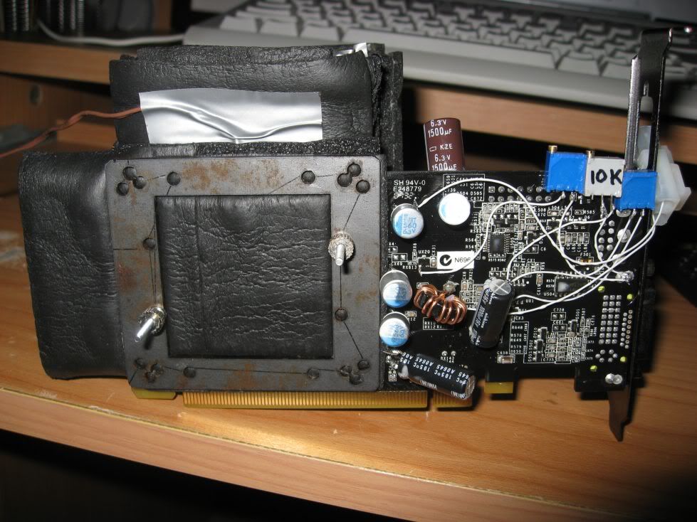

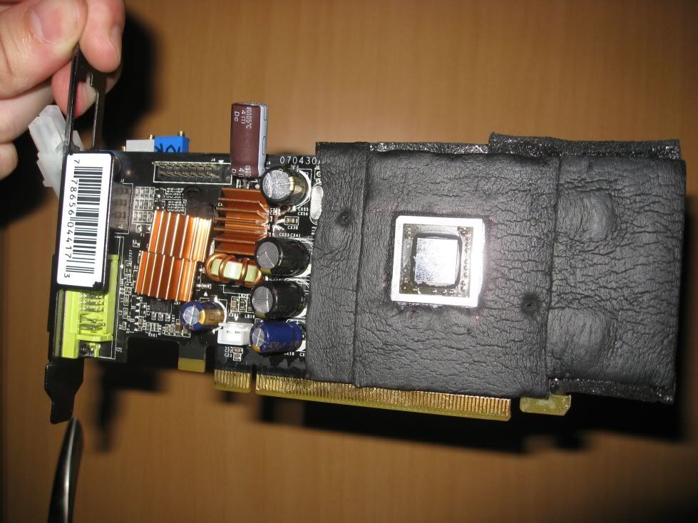

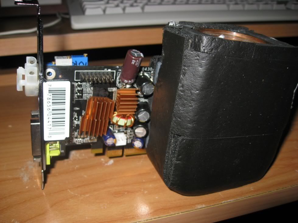

My updated mods and successful first test post-mod
http://img.photobucket.com/albums/v310/T_M/IMG_2838.jpg
http://img.photobucket.com/albums/v310/T_M/IMG_2840.jpg
http://img.photobucket.com/albums/v310/T_M/IMG_2841.jpg
http://img.photobucket.com/albums/v310/T_M/IMG_2844.jpg
http://img.photobucket.com/albums/v310/T_M/IMG_2846.jpg

Put the bigest fan you have on those fets, maybe they will last long...i hope for you they are.
T_M there's a little bit of space in there I think you can fit some more caps :p:

Looking good - you worries about the GDDR2 temps tho?

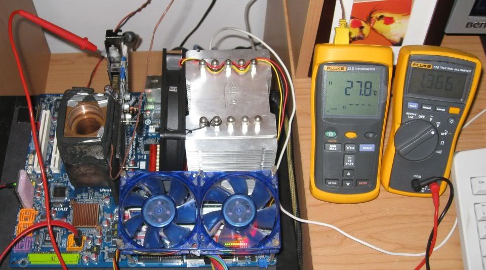

did some quick testing last night
my card does 675/510 without artifacting in ATItool at 1.34vcore/2.05vdimm
i did some quick 01 runs at same settings with different mutlies at 3GHz/3.5GHz/4GHz with an E6850
results were around 23.4/23.5/23.6
talk about scaling hahahahahaha
i'll try mounting that TTBT on the core and push hard on the vcore and see where i end up with more volts....shame about crappy RAM :(

Also have my "scrap" water cooling setup done enough to run now. Those old Danner Mag 5's are a bit noisy lol.... but it flows like crazy! ;)
904/2322/475 1.92v core 2.2v mem through 03, 46c loaded ;)
