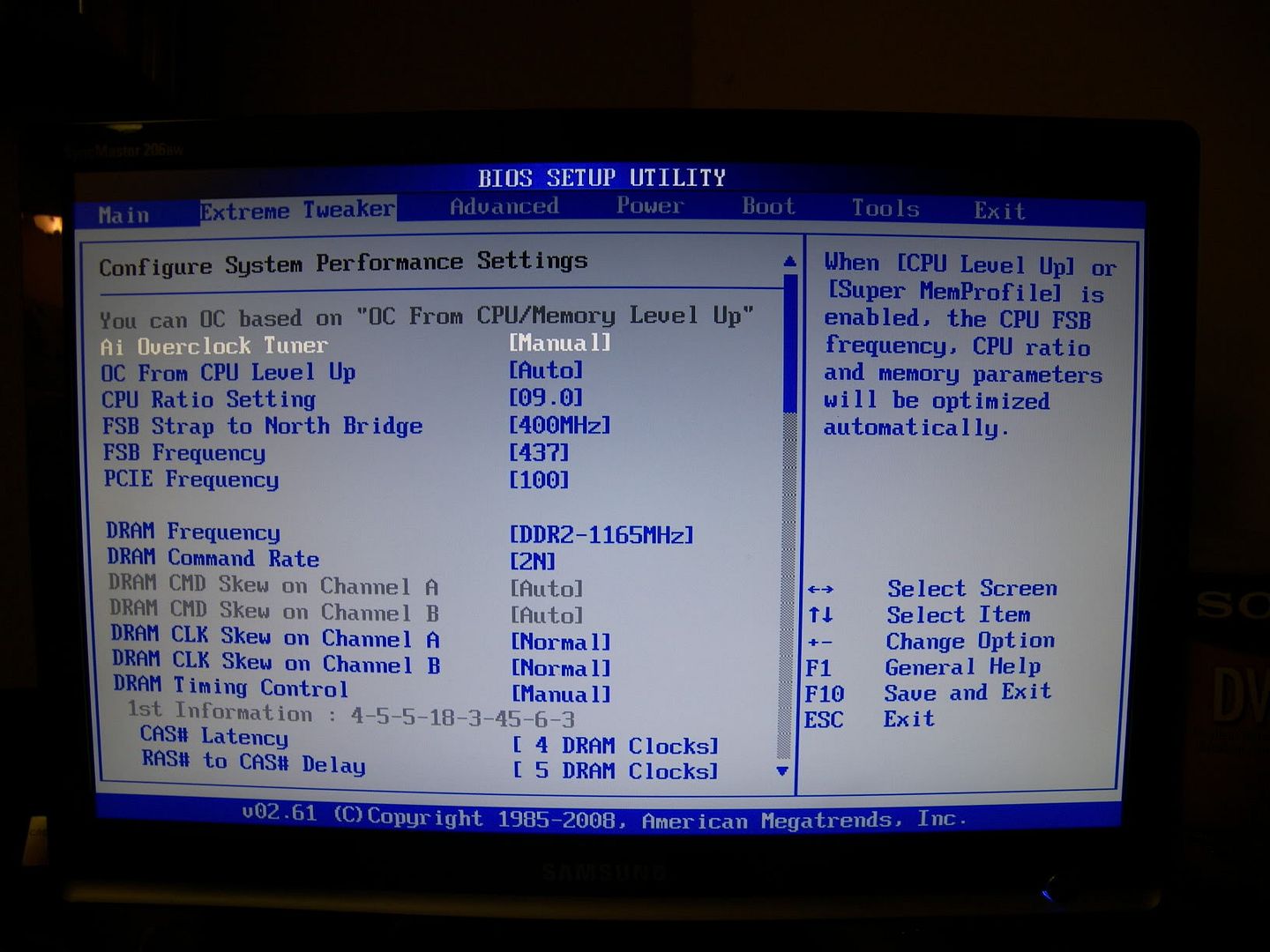

hi, i m gonna flash my maximus to rampage soon...just wondering do u guys still follow stilt's steps or just simply type in AFUDOS /ifilename.rom /pbnc /n and ifilename.rom would be the bios file??? no more entering to ezflash to flash anymore right?
should help stabilizing a higher fsb oc... or at least this was my experience with the abit ip35-pro i had.

you need to mess with transaction booster and common performance level. i noticed a drop from switching to a rampage, but once i toyed with these settings and made sure its stable, i got better bandwidth than i could with the maximus.

Both work fine Tiramisu... I ran the Q6600 on 0907 and also with the QX9650 no issues... updated to 1003 hell broke loose... reflashed back to 0907 all fine, now tested 1004 and it runs fine with Q6600 and my Gskills 4gig kit... no worries... I think Kup advises to use 0505 for Q6600...
1. boot from usb
2. AFUDOS /RF0219.rom /pbnc /n
3. done
correct? just to confirm :P
alrite got it thx :)

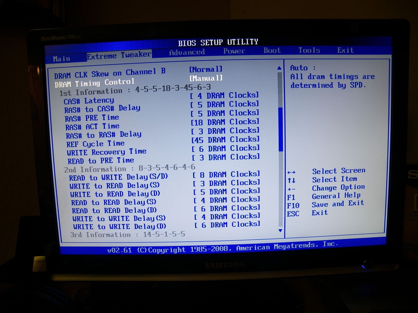

would anyone care to share there memory settings?
that pull in/out isnt making sense to me, If I play with it I get the "det dram" hang, then it takes forever b4 the pc will boot again.
Frustrating as hell. Finally had the Maximus sorted now its back to start again with Rampage
yes but without actually changing the internal mobo timings i guess....

im getting some mixed results. DET RAM errors all over the place with similar settings i had used on the maximus BIOS... on the other hand however, cpu voltage is now lower, and amazingly, my load temps dropped 2 Celsius on full load~!!
its easy...imagine that you give pl5 with all phases disabled...you still have pl5
if you give pl5 with phases enabled you actually have pl4......
soooo,with fe 400fsb you`ll work with pl5-disabled...but not with pl5-enabled...too tight..

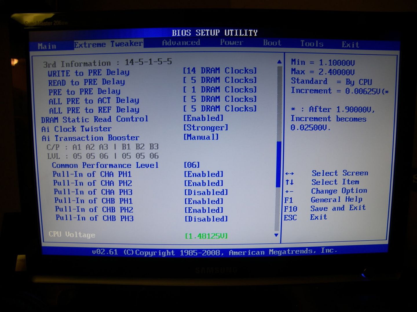

I was able to tweak abit and have managed to get respectable bandwidth again, but however I would like to run 4-5-5-15 to reduce latency if possible.
http://i237.photobucket.com/albums/f...ger/newrmp.png
Anyways my wife has my camera atm so here is basically my mem settings
5-5-5-15-3-40-6-3
All other settings are AUTO
Dram Static = Auto
Clock Twister = stronger
Trans Booster = Auto

http://i48.photobucket.com/albums/f2...76/timings.jpg
http://i48.photobucket.com/albums/f2...Picture003.jpg
http://i48.photobucket.com/albums/f2...Picture002.jpg
http://i48.photobucket.com/albums/f2...cture001-1.jpg
those 2 pull ins that are disabled are now enabled... i just noticed it when uploading the pics
sorry for the large pics
