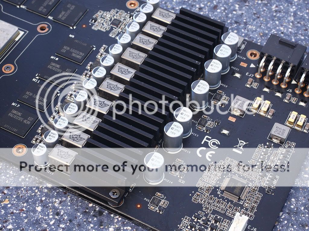

http://i55.tinypic.com/k4e7pi.jpg
^ a few extra mhz/higher performance per clock/increased IQ - texture depth/rez
unfortunately puts great load on the system so i dont recommend it up to you guys
Nice work. Can you expand on your comment 'puts great strain on the system' ? They look like 330uf Tantalums, that shouldn't load it up too much capacitance wise although the cap size may change the timing of the circuit inappropriately and a different size may be better. If you feel 330uf is not optimal, can you try something in the 100 - 270uf or >330uf range? The Direct CUII is running 470uf tantalums and the GTX480 uses 390uf polymers.
thanks.. from 4.8ghz i had to lower i7 980x to 4.6ghz then when liquid temp rose had to lower to 4.4ghz unless i kept the liquid cool i had system instabilities
thats i used the very same caps used on the rest of the card: aluminum panasonic ecg polymer 2.5v 330uf 6.0mohm esr
at first i was surprised too just how much load it felt like lol but after the results im ok with it
yeh i couldve gone with 470uf or like the ones on gtx480 but since the waterblock covers over these caps i was in no mood to try different capacitors+capacitances
i didnt test single card went straight to 3x cards but for a single card id say this mod is a go the load wouldnt affect the system as much
That's odd, to me that sounds unrelated. Having to lower CPU 400MHz to remain stable and then experiencing instability as liquid temps rose sounds system (not VGA) specific. Unless your cards became unstable at same clocks/voltage (and in fact you said you gained clocks), I'd suggest it's something other than those caps causing the CPU issues.
The caps don't cause the card to draw more power, nor run hotter. They just filter the mosfet DC output and the only added load would be the initial inrush current at power on when the mosfets have to charge the caps.
