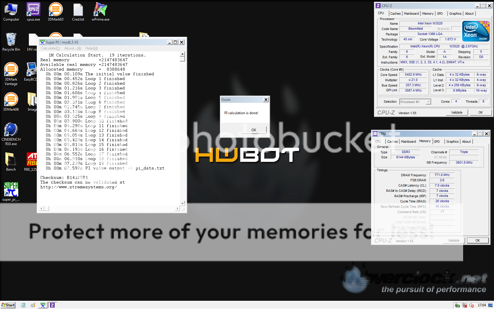

http://img176.imageshack.us/img176/6046/r342135.jpg
bios 1003 best for me between 0901/0011/1003
Still testing..
advice is welcome !!

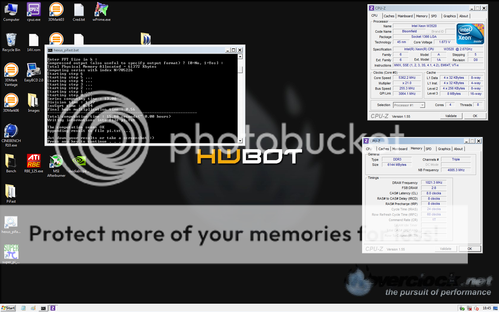

Stable HT on..
Cant run it with 1.81 pll, errors every time..
http://img691.imageshack.us/img691/5...tonstabiel.jpg
Now raise BCLK !!
