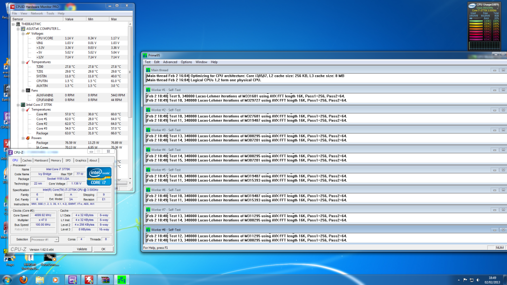

Heres a mild overclock of my 3770k 4.7ghz 1.136v stable on prime 95 6 hours gonna see if i can push it to 5Ghz
batch: 3226c459 anyone else have this batch?
http://i1050.photobucket.com/albums/s414/tpwilko/47.png
very nice chip,surely u can reach 5 ghz...what mobo?
@tpwilko: What have you tested vcore with? Or just vcore to boot? I like Cinebench for a rough estimate, or vcore to boot and run spi 32m at 5ghz.
EDIT: Sorry, haven't slept well and I missed the prime95 run... :p Congrats! Hope it will continue to climb up once pushed properly and on cold. :D
...and how's the imc?
based on my experience with ivy's i would say that chip can do 5 ghz prime stable in 1.28-1.35 range.Awaiting updates from tpwilko :D
