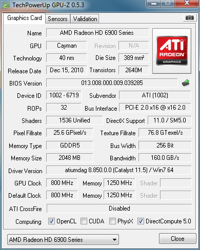

Hey Guys, Had a good read through some of the pages, however I am having serious troubles flashing my card. Here is the info:
http://gpuz.techpowerup.com/11/06/05/2sf.png
I have tried a bunch of Bios files downloaded from the net however non seems to be working. I am using ATIWinflash and I get the "CANNOT ERASE ROM" Error. Any thoughts?
All I really want to do is get past the 840Mhz OC Limit :(
Thanks.

I just followed the directions on this link HERE and I got the same error! GRRRRRRRRRRRRR. I DID NOT DO ANY OTHER MODS OTHER THEN RUN THE BATCH FILE.
You need to run ATIflash via commandline. The directions are right on the Techpowerup guide.
Ah, did i miss the "via commandine" option? I didnt read anything about that. It says nothing about commandline in this link - http://www.techpowerup.com/articles/...ng/vidcard/159
HOWEVER, I just used THIS option, but instead of using a 6970 BIOS, i just used the "modded" file that created by the batch file, and that worked.
Now to see if I can get some decent OCs from this sucker :)
http://gpuz.techpowerup.com/11/06/05/cks.png
Ah, it seems I am the lucky one who gets to do this:
Will give this a try now.Quote:
If you get an error like ID mismatch or Could not erase ROM, then you'll have to do some extra work in a Windows command prompt (or DOS): Run atiwinflash -unlockrom 0 followed by atiwinflash -f -p 0 bios.bin where bios.bin is the path and filename of the HD 6970 BIOS you downloaded.
