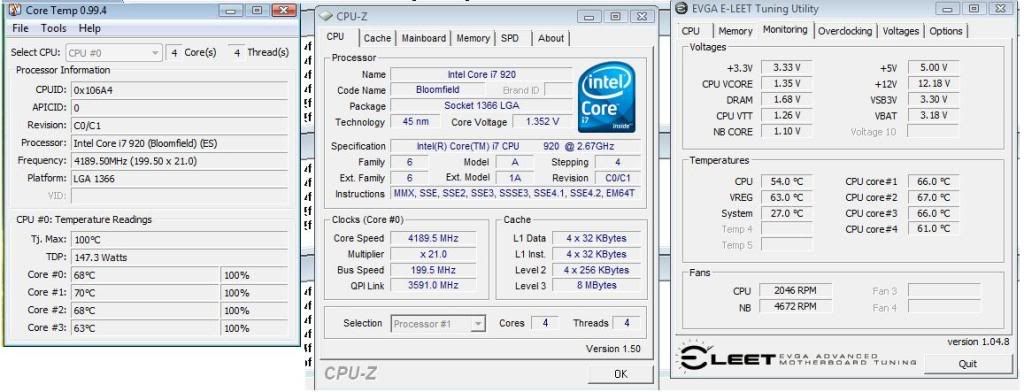

Ok then :) now I have come to my 24/7 setting.. Think this is quite good though.
Vcore - 1.40(bios) 1.37.6(unloaded) 1.36(Loaded with LinX)
QPI/VTT - 1.38
vDimm - 1.70 (1.69)
Uncore @ 18x 3600
HT - OFF
Turbo - ON
Batch #3841A627
15 run of LinX ALL mem button, Realtemp shows minimum and Maximum temp, Avarage during linx was 62 highest, and 55 lowest core.
Http://hem.bredband.net/infan/i7/i74200.jpg
CPU:
vCore: 1.3v (bios) 1.35v @ load
VTT: 1.2v (bios) 1.27v (cpuz and load)
Dimm: 1.65v (bios) 1.68 @ load
Uncore: 16x
HT: off
Memory: (forgot to screenshot it)
798mhz
FSB: DRAM 2:8
8-8-8-8-24 74
Batch# 3841A574
Here is a pick @ max load
http://img.photobucket.com/albums/v2...htGuard/42.jpg
9 hours prime95 stable.
Cooler: TRUE push
Anyone think I can get any further on my TRUE or have any sugesstions any of my other settings? New to Intel OCing.
