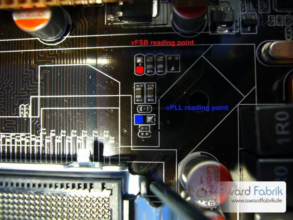

Also my +12v is 12.15v according to a DMM not as in speedfan.
Vcore goes from 1.224v load to 1.264v idle ( believe I'm lower than what the bios gave by default, I've been seeing 1.3v in everest for default.)

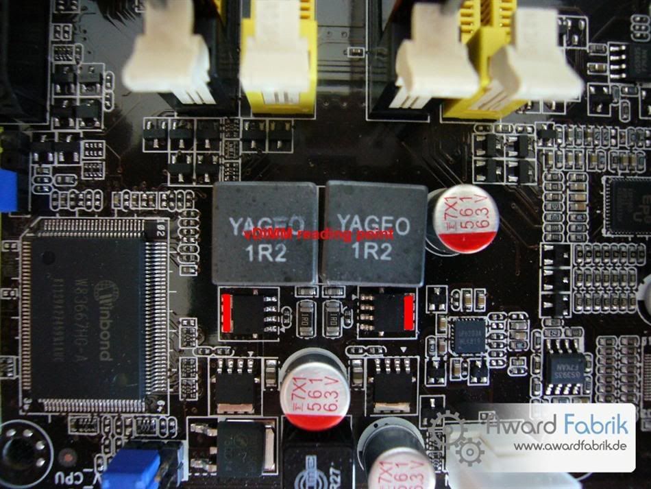

Has anyone got big differences in bios set voltage and reported voltage? In the bios hardware monitor it show the vCore being set alot less than I selected and then with load line calibration off there is a 0.7v difference between selected and set volts.
I set 1.3825v bios for my q9550 and at in CPU-z it reports 1.35v idle and then load it goes to 1.30v.
It could work fine, at these volts until it starts rebooting spontaneously. I am trying to get 24/7 stable clocks.
I can't read the vCore with a multimeter since I don't know the measurement point, I know the points for other readings. With these 45nm chips they are not as tolerant to voltages as previous generations.
Which is correct, the bios setting or the reported voltage?
