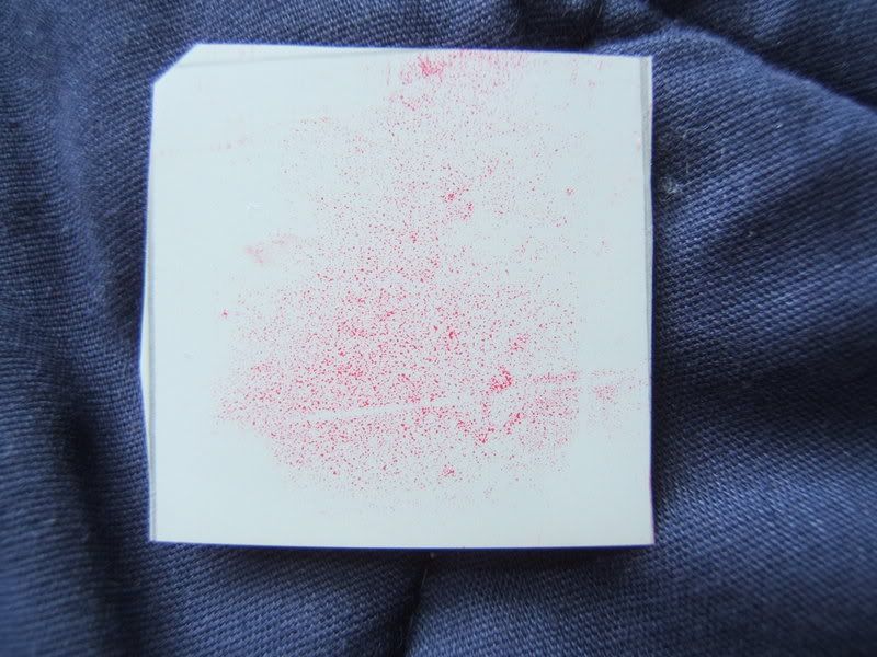

used up my pressure films last night but can't seem to get a good pic. haven't uploaded them to see if they're better on the pc but i doubt it.
i was very surprised at the results. seems i have a pressure issue with my TR ultima 90, i already had 1 washer on each screw but showed very little pressure. moded in a 2nd washer and got much better results. i'll have to start thinkin of a way to replace the current mounting method or if i can replace the screws with threaded shaft(or cut the head off a screw) and use some kinda nuts to tighten down on the springs :shrug:
64Dragon
I think you should just upload them to us that way we are not guessing what is going on. :)
fine fine, i'll post pics before you guys pull out the pitchfork's and torches.
for those of you that didn't do this yet, don't hold the 2 films together in your hand/in between fingers. i ruined one of the films that way :(

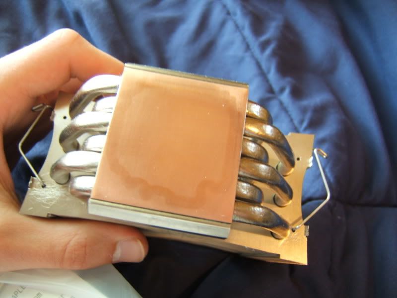

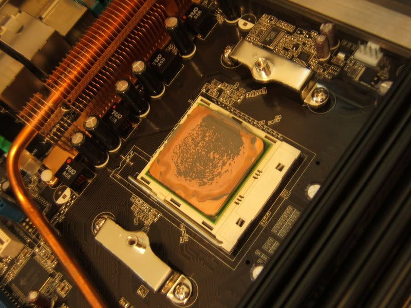

heres what i found when i pulled the heatsink off
http://i37.photobucket.com/albums/e9...e/DSCF3210.jpg
cpu side
http://i37.photobucket.com/albums/e9...e/DSCF3218.jpg

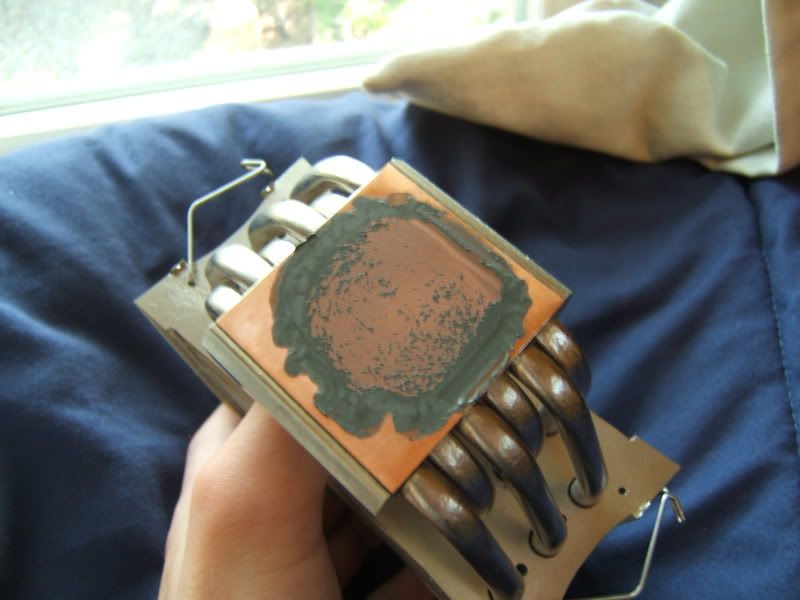

once i cleaned the paste off there was a ring left on the heatsink and cpu, heres the one on the heatsink. no matter what i did nothing got it off
http://i37.photobucket.com/albums/e9...e/DSCF3221.jpg
first pressure film, i left the case horizontal, it looks marginally better in person, camera didn't want to focus on it
http://i37.photobucket.com/albums/e9...e/DSCF3226.jpg

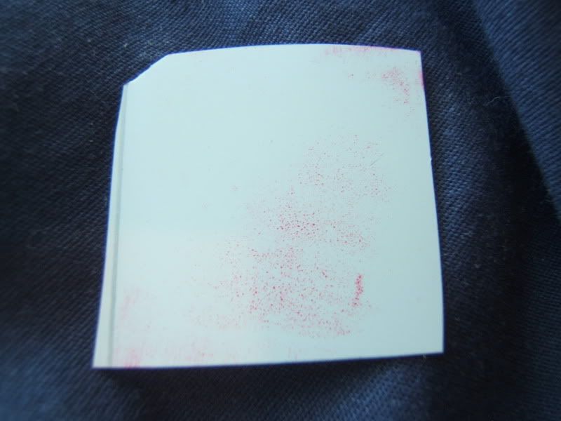

second film, this time i turned the case up how it would normaly be. i have no idea why is so dark, i took 5 or 6 and they were all dark too
http://i37.photobucket.com/albums/e9...e/DSCF3231.jpg

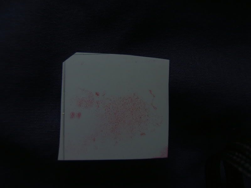

third film, modded the cross piece that holds the heatsink down adding a washer to it so its applying more pressure
http://i37.photobucket.com/albums/e9...e/DSCF3237.jpg

i guess i found my explination why the core temps are so different, i don't have even coverage and pressure. forgot to mention, the cut corner relates to the gold corner on my cpu. also, for the 3rd test i rotated my heatsink 180 and that seemed to help even out things
64dragon
Why not send me back the first and last test samples then we could compare the temps before and with improved contact. The third one looks pretty good.

i think its fairly good at both, once you get the analysis done on the film you get a good idea of what kinda pressure your applying. i thought i had good pressure but after seeing that first film it was apparent that i didn't. the film also gives a fair idea of how your contact is because if it isn't red after then there is no contact there on a direct contact to contact scenario, this is why we use thermal paste though, because its extremely hard to get both bases completely flat. also, if both surfaces were completely flat the metals should theoretically fuse together.
