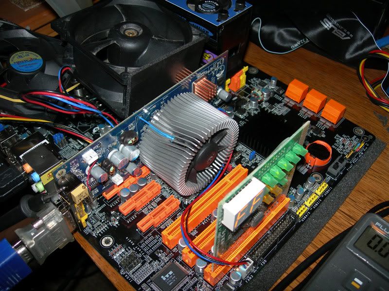

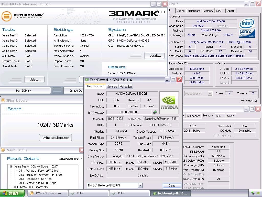

Sounds like it's time for a new card Andy. This DDR2 Zotac is pretty good, 1.53V - stock memory voltage :)
The cap ratings (solid) on this thing are pretty amazing in itself, especially for a low end card. If they we're doing this kind of thing on high-end we'd all be buying Zotac cards.

OMG that's crazy G H Z :shocked:
1.53V for 550Mhz :eek:
Nice score GHZ, can you post a link to futuremark and I will stick it in for #1 spot. Same for any 2001 score.
That heatsink looks like it belongs there as well, nice choice.
