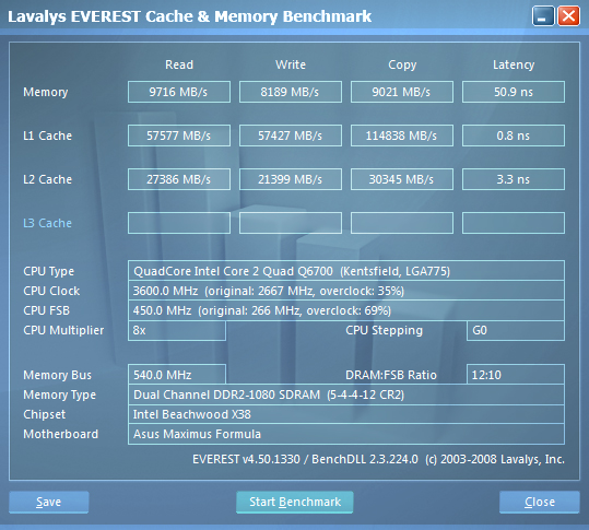

http://i237.photobucket.com/albums/f.../test16700.png

Hey Grnfinger, I see a small increase in bandwidth and it lowered latency a tad. I also noticed you were able to lower your timings a notch. You deffinitly attribute this to 1102? Are you able to eek out a little more on your 6700?
My problem with my Q6700 is I have a hard time getting it stable above 3.4 @ 1.31v. I'm sure if I took the time (and maybe a little help from you ;) ) I could take it up to 3.6 like yours with some tweaking and a bios update (currently 907). But it just doesn't seem that these newer 6700 do 3.8 real easy. My VID is 1.27. Maybe you could give me a hand when I get a little extra time to frick with it?
