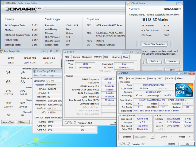

^ thanks bro. yup its stable.. but i want to lower my vcore.. i think its high.. here's another, but different procie.. E7400,, =)
http://i42.photobucket.com/albums/e3...hz3dmark06.png
How high is the FSB term voltage ? Sometimes upping there can reduce ya Vcore a bit, this conciding with GTL tuning. Don't expect miracles of it though... If ya really are scared of the voltage just use the CPU at 4Ghz... good rams help loads with quad clocking...
FSB term voltage is at 1.34v, im still waiting for my 1200 rams from US to the philippines.. hope it will arrive soon.. =) thanks leegh for the inputs... =)
dude if anything you cpu voltage is suprisly low for that clock mine is only doing 3.8 and is stable at 1.55... i suppose i can affort to as am watercooling it...
by the way did you 3d mark it?? if so whats the score?
