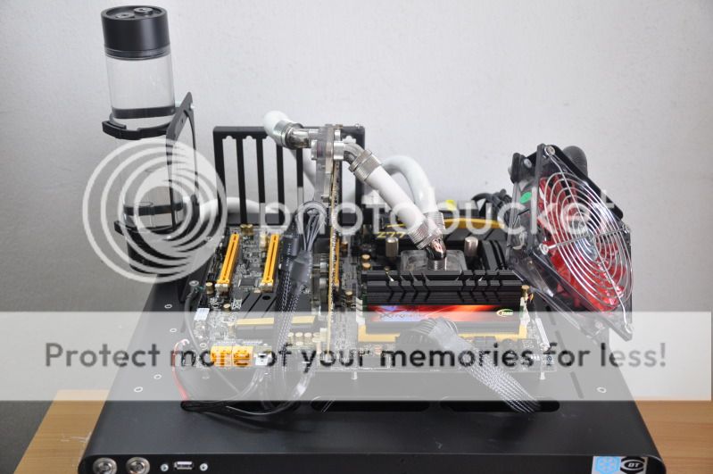

http://i458.photobucket.com/albums/q...k/DSC_0092.jpg
CPU: Intel Core i7 3770K @ 5.0GHz
MB: ASRock OC Formula, BIOS P1.60
DRAM: Team Xtreem 2600 10-12-12-25-1T 2 X 4GB
GPU: Gigabyte HD7970, MSI's special BIOS, Driver Catalyst 12.11 beta, CAP 12.10
Storage: 2x Crucial M4 128GB, FW 000F
ODD: LiteON DVD-RW
PSU: Corsair AX1200
Cooling: Custom watercooling - EK Supreme HF plate #6 CPU waterblock, 2x XSPC RX360 radiator, Swiftech MCP655 pump, EK FC7970 GPU waterblock, EK Multioption X2 Advanced reservoir, XSPC 1/2" ID 3/4" OD white tubing, 12x Scythe GT AP-15 1850rpm 120mm fan + Aerocool Shark 120mm fan, Coolaboratory Liquid Pro thermalpaste etc.
Casing: Dismatech Easy Dual V2 Bench Table
OS: Windows 7 Ultimate 64-bit SP1

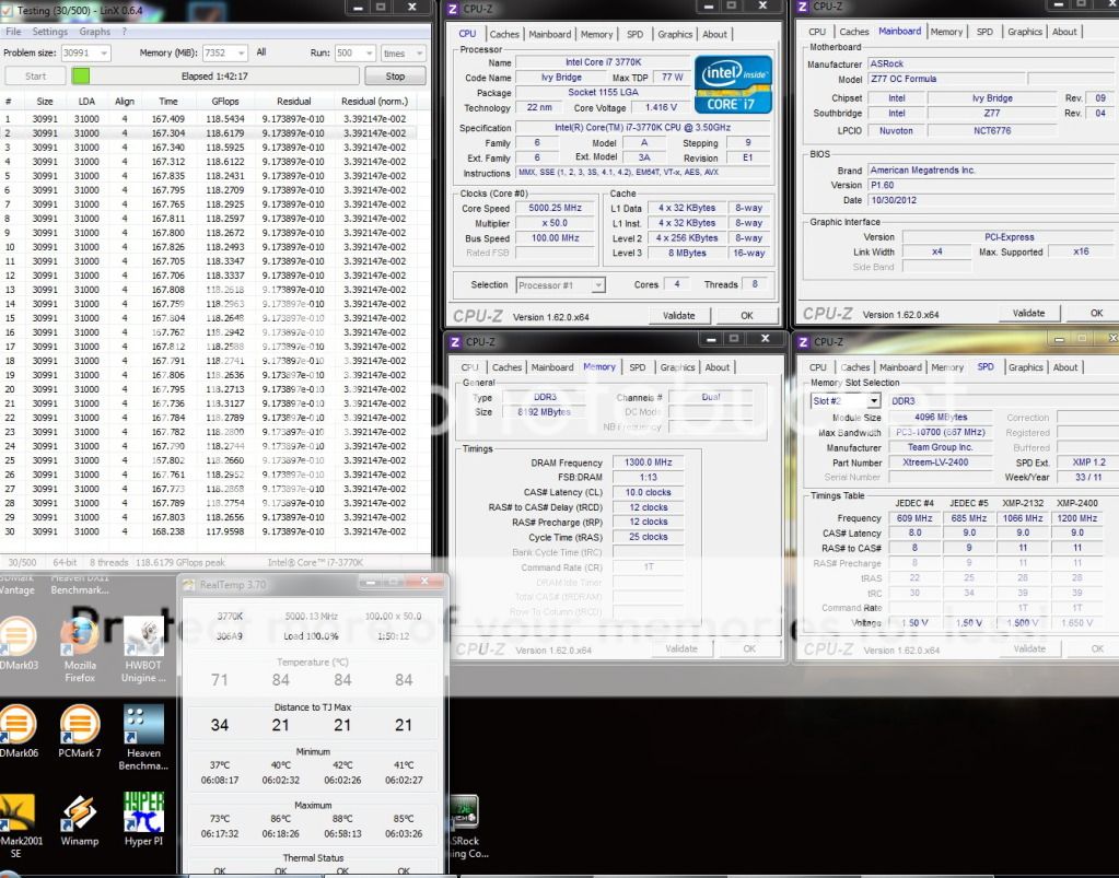

5.0GHz @ 1.416v | LinX 0.64 (11.0.1.005) w/ AVX:
http://i458.photobucket.com/albums/q...LinX141v-1.jpg

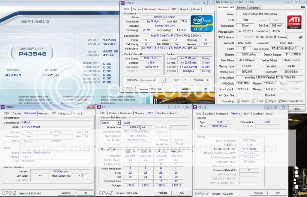

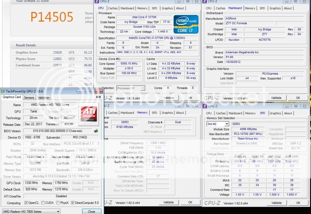

3DMark11:
http://i458.photobucket.com/albums/q...330tessOFF.jpg

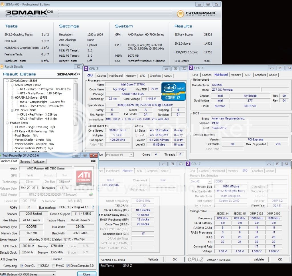

3DMark06:
http://i458.photobucket.com/albums/q...ock/3d06-1.jpg

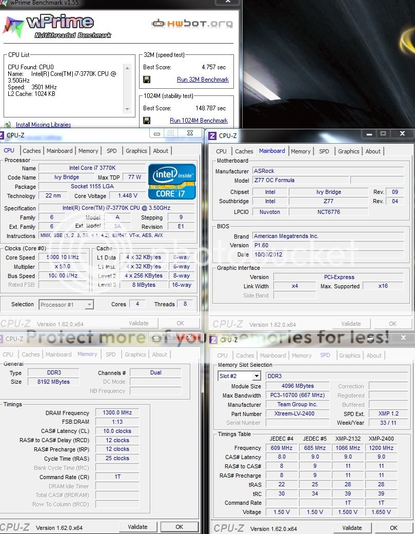

wPrime:
http://i458.photobucket.com/albums/q...k/wprime-1.jpg

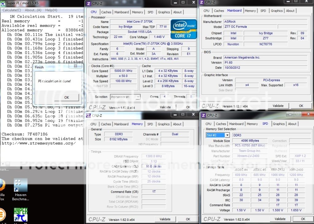

Super Pi 1M:
http://i458.photobucket.com/albums/q...srock/1m-1.jpg

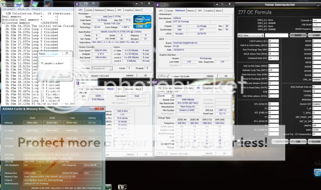

Super Pi 32M:
http://i458.photobucket.com/albums/q...rock/32m-1.jpg

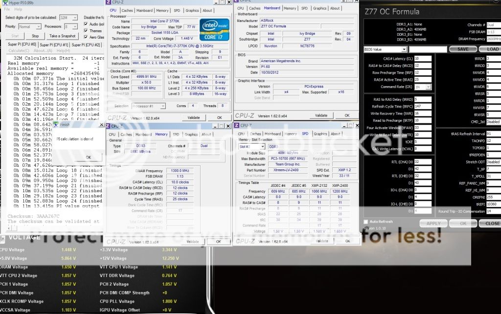

Hyper Pi 32M:
http://i458.photobucket.com/albums/q...k/hyper2-1.jpg

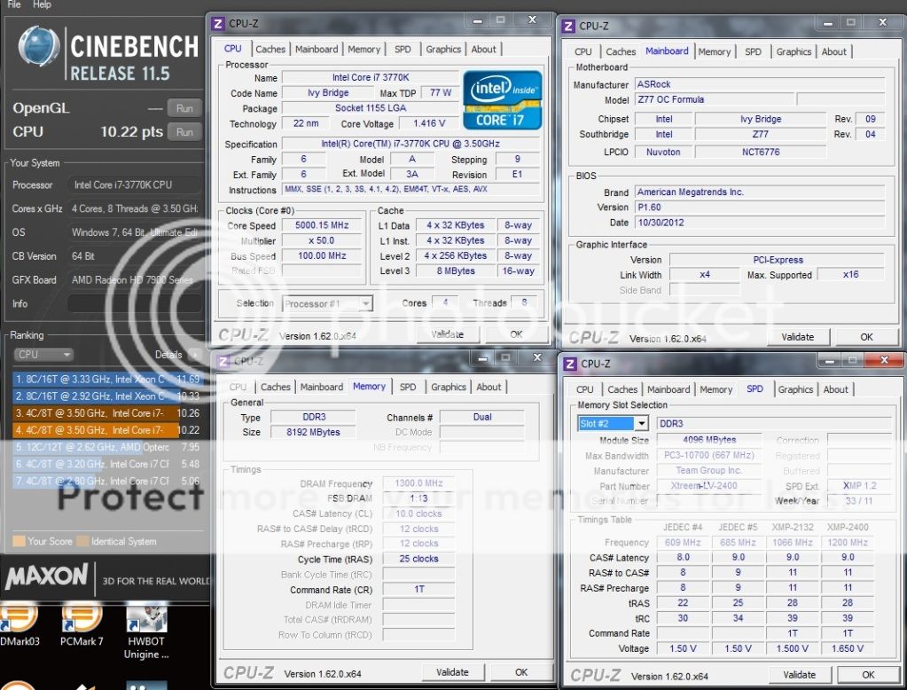

Cinebench 11.5:
http://i458.photobucket.com/albums/q...benh141v-1.jpg

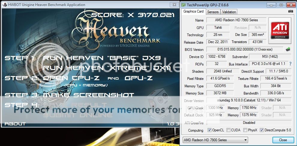

Unigine Heaven XS:
http://i458.photobucket.com/albums/q.../unigine-1.jpg

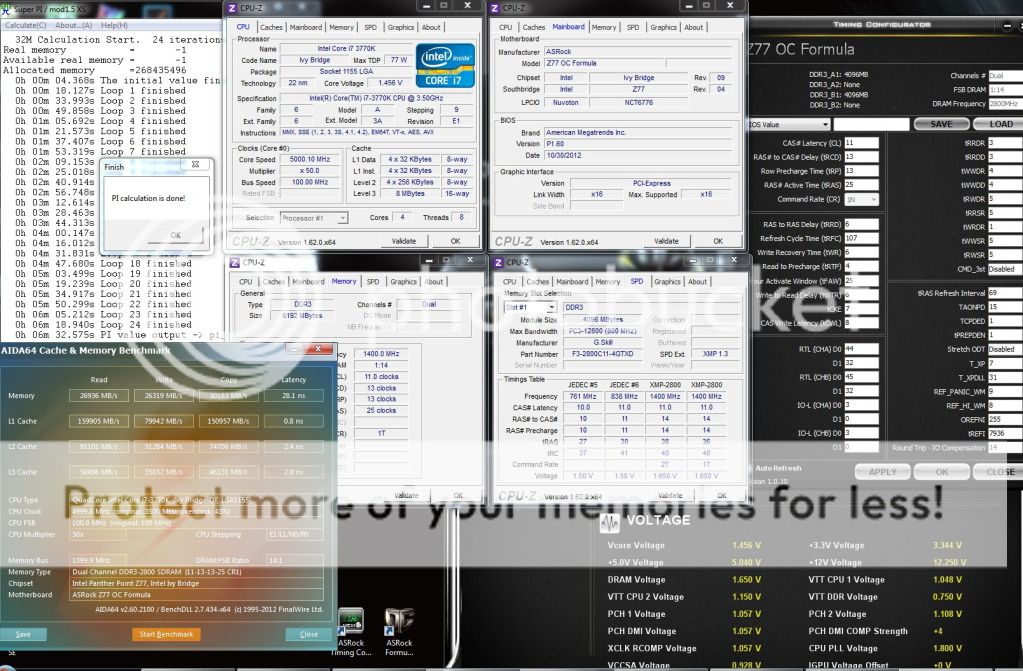

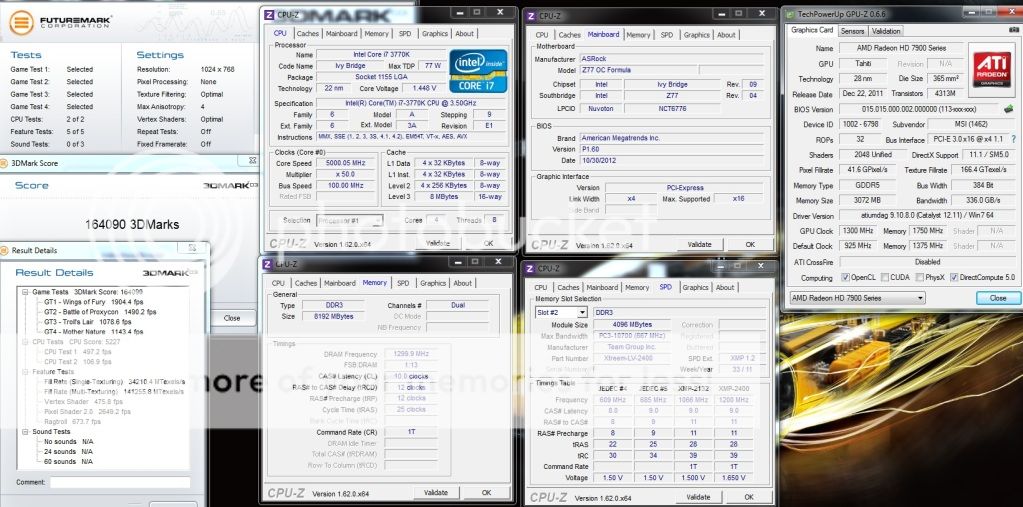

Super Pi 32M Benchmark with Samsung IC RAM:
Team Xtreem 2600C10 @ 2666 9-12-12-25-1T
http://i458.photobucket.com/albums/q...6669-12-12.jpg

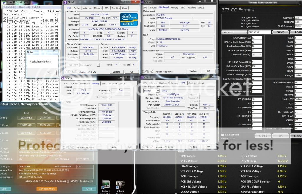

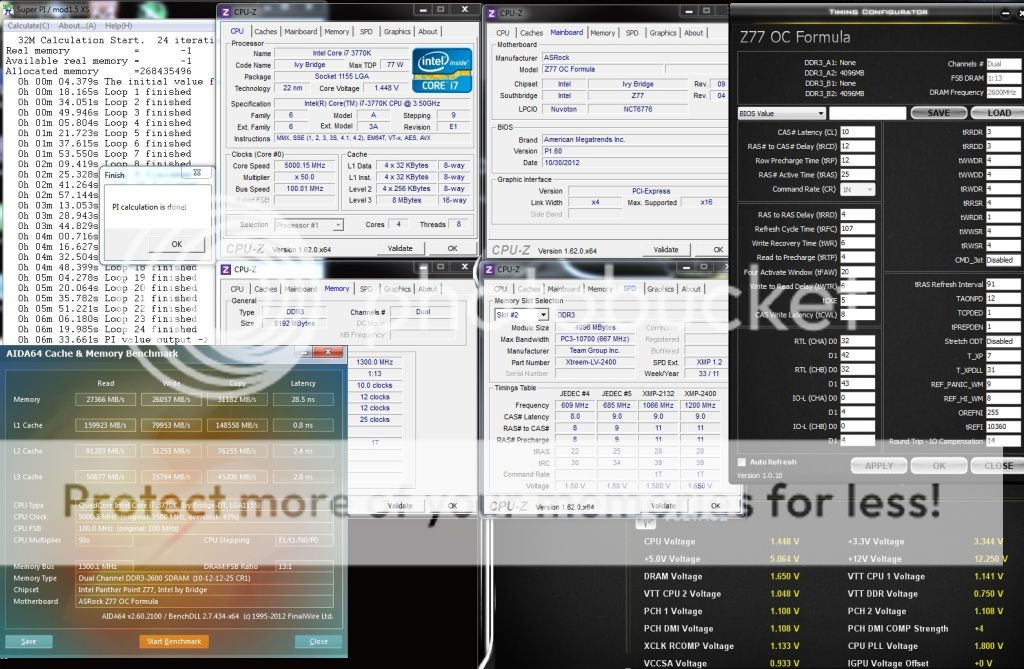

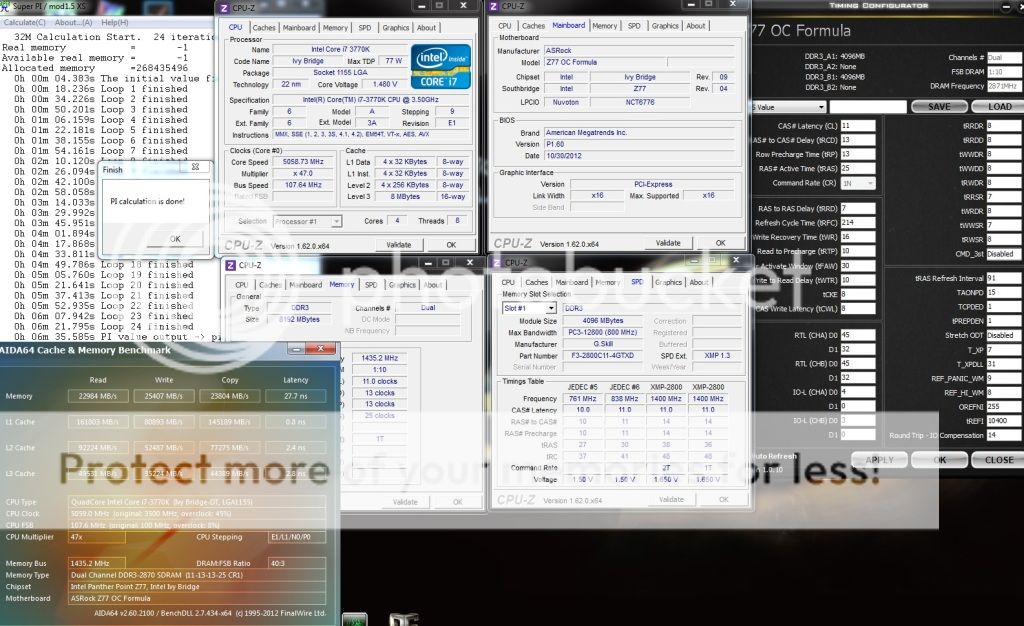

Team Xtreem 2600C10 @ 2709 10-12-12-25-1T
http://i458.photobucket.com/albums/q...0-12-12-25.jpg

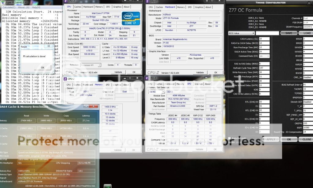

Team Xtreem 2600C10 @ 2766 10-12-12-25-1T
Team Xtreem 2600C10 @ 2800 10-12-12-25-1T
http://i458.photobucket.com/albums/q...12-12-25-2.jpg

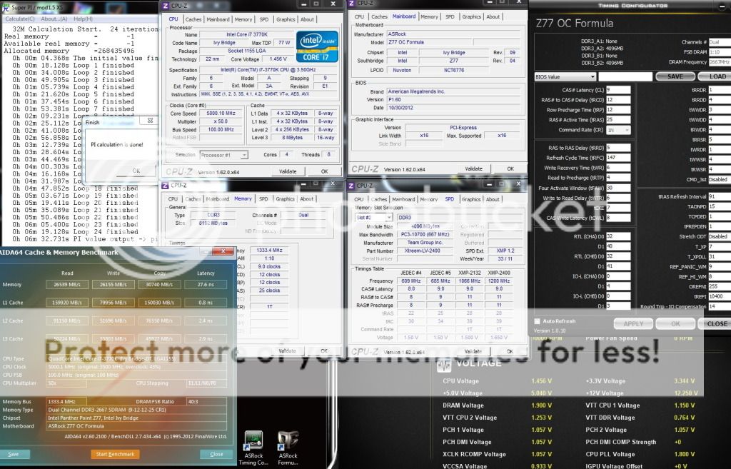

Super Pi 32M Benchmark with HyniX IC RAM:
G.Skill TridentX 2800C11 @ 2800 11-13-13-25-1T
http://i458.photobucket.com/albums/q...1-13-13-25.jpg
G.Skill TridentX 2800C11 @ 2870 11-13-13-25-1T
