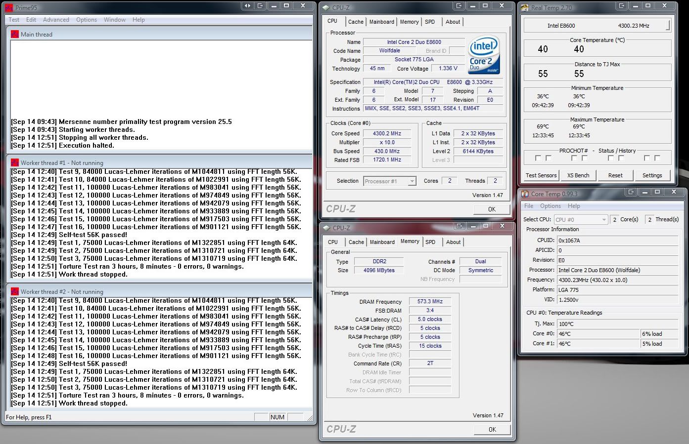

My humble contribution...
Click to enlarge
http://img.photobucket.com/albums/v8...S43Ghza900.jpg
E8600
Batch: Q820A604
First attempt, I will try to get more later. I hate my temps right now but that's what I get for living in the tropics.:)
