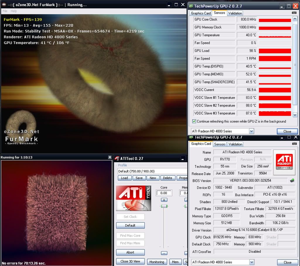

This is what I've got going for now. This is the first OC I tried right off the bat. More will come later when I receive my XSPC Razer full cover block and I start messing with the bios. ;)
For know I'm cooling my card with the MCW60 and the stock heatsink's metal back plate for memory and VRMs (not using stock fan, though). OCed with AMD GPU Clock Tool, all stock voltages.
Furmark + ATI Tools to check stability. :D
http://i59.photobucket.com/albums/g3...B/bf4e28d2.jpg
Edit: Apparently the reason for renaming it is because "Catalyst 8.8 have been optimized to detect FurMark and downclock the frequencies of a Radeon HD 4850/4870 to avoid to burn the GPU". But as you can see AMD GPU Clock Tool seems to overwrite that problem since my clocks didn't go down.
I did renamed it and FPS was the same. And please, describe how does it "cripple" it then.
It doesn't need to be 1280x1024 minimum. What makes you think that? How is that a requirement?
I'm running two programs stressing the GPU quite a lot, Furmark at 640x480 + ATI Tools is enough to test stability and is more that what most people do to test it. No need for 1280x1024, even if I did change the res the result is the same, just lower fps.
Driver limits the FPS. For specifics ask ATI, not me. One thing it can do is simply force the GPU to render every second frame only and that cuts the FPS in half and the load by 50% :) In terms of resolution not mattering, you have got some major stuff to relearn about graphics it seems. By your logic running games at 640x480 vs. 1280x1024 would be the same. Think about it ;) Anyway, if you got off on the wrong foot this morning don't take it out here or on me. I simply pointed out a test for you that will really push the limits of that OC. If you do not care to try it, don't, I got nothing to lose.
Also, if you are running Vista that explains the FPS not changing. On my system in Vista 64 FurMark runs bad. FPS are always low so they seemingly stay the same all the time, no matter what res you are running. In XP it is very different, resolution to resolution.
Again, try it or don't, I really do not care. I was simply trying to make a suggestion on how to test.
I'm not saying that in games running a lower res is the same as a higher res, I'm saying that in this case, I am already running two GPU intensive programs at the same time, hence the low res is fine. I'm not taking anything out on you, I'm just asking where do you come up with stuff like "1280x1024 minimum", as if there was some sort of rule. If I was running Furmark alone, then I would understand, but you still don't seem to get that I'm running Furmark and ATI Tools at the same time. I don't need to run it at at high res because I'm already getting a high enough load on the GPU. If I go by what you're saying then what the hell I could just come off and say, no it's 1600x1200 minimum, where did I get that? It's a rule I just made up. Furmark at that 640x480 + ATI Tools is good enough, no game is going to stress it constantly so much and like I said before, most people don't even stress test their GPUz that much and call it stable. I'm running XP and I admit that FPS went up, at first I thought it didn't because it looked the same, but then I discovered it was because I was opening GPUZ and while GPUZ opens, it makes the FPS go down. Still even after renaming furmark and upping the res, the load on the GPU shows to be the same on GPUZ, and results are the same.
Just because I didn't set the highest possible stress test you can think off on the card doesn't mean it's not good enough to test stability. I could set Furmark at 1600x1200 and run ATI Tools and then someone could come and say, hey but why not run a second instance of Furmark to really stress stability, but that doesn't mean that the way it was previously being tested wasn't good enough. That's all I'm trying to say.
Dejanh was just trying to help. ATI made a profile for Furmark starting with the 8.8 driver to slow it down because people were overheating their 4870's.
The way I came up with the 1280x1024 minimum is that I found on my 4870 that it did not overheat or crash if I ran FurMark at anything less than 1280x1024 in the stability test. 1280x1024 or higher would cause the temps on the VRM to skyrocket and the card to crash. I guess it is a personal experience only...I just went by it anyways. I do agree though that if your GPU load while running ATITool and FurMark in your setup is at or very near 100% for the whole duration that is then good enough.
