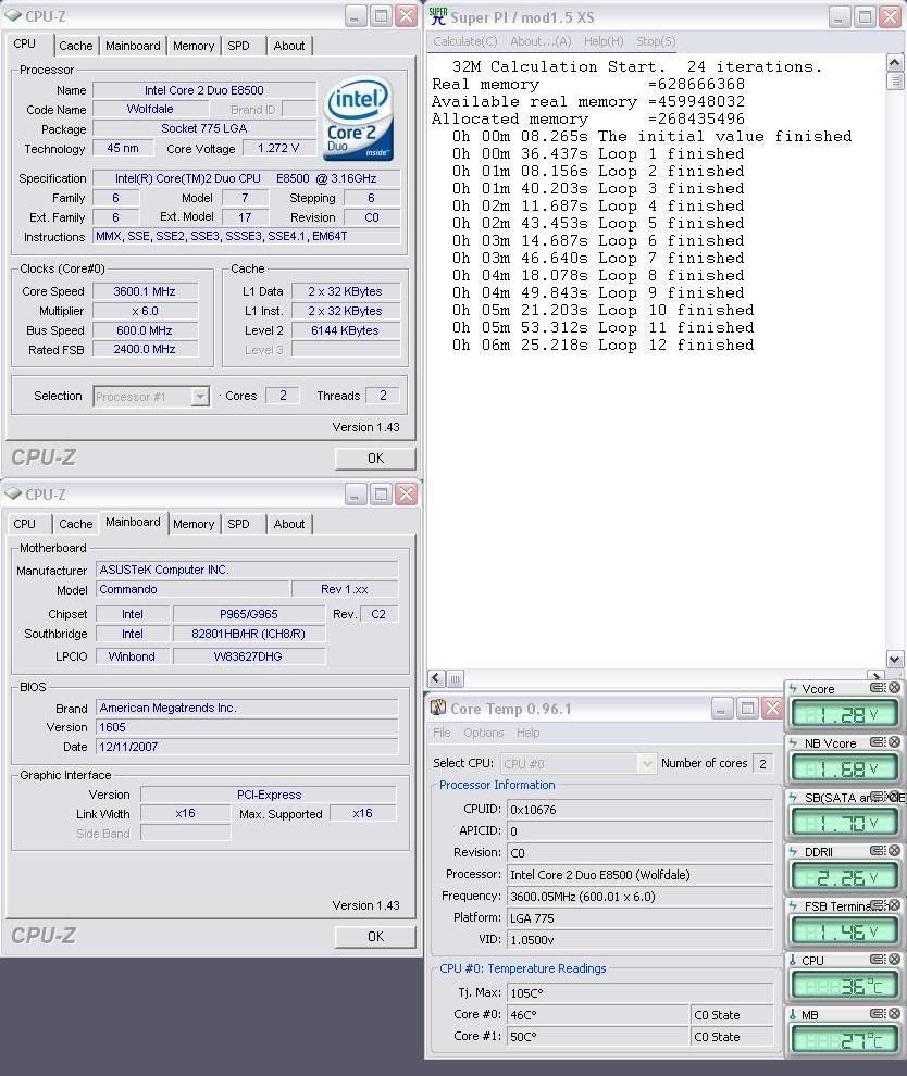

Testing max FSB of me E8500. 32M time is horrible, slow mem, no tweaks and apps running. FSB not too bad though :D
Commando bios 1605
Tuniq Tower (room 20 C)
E8500 Q745A554
Ballistix 8500
8400GS
OCZ 520 mod
Boot 6x600 32M loop 12:
http://img.photobucket.com/albums/v6...op12600fsb.jpg
32M:
http://img.photobucket.com/albums/v6...done600fsb.jpg
http://img.photobucket.com/albums/v6...20FSBE8500.jpg
