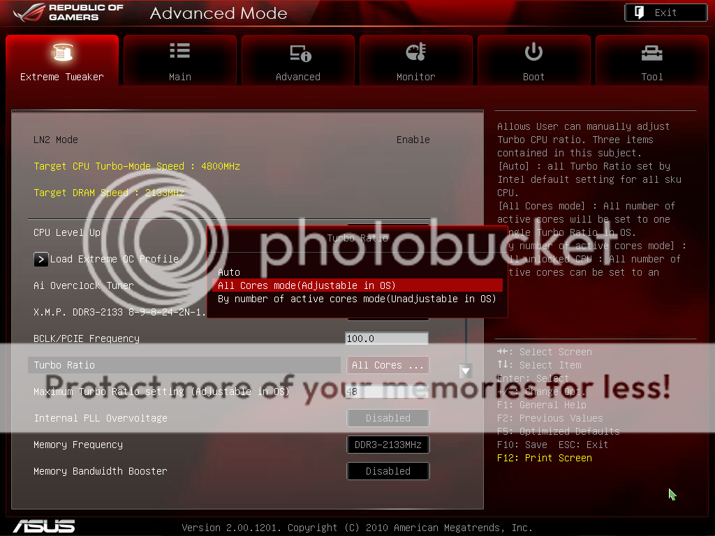

I hate this donkey gonkey board.. Intel Core i7 2600k @ 5ghz 1.375v (50x100) boots windows and is LinX/IBT and Prime64 stable for 24hours, yet it refuces to boot into windows with 1.5v and 51x, 52x, 53x, 54x, 55x and 56x, it goes bios fine with all of those multipliers.
Cooling aint problem since its LittleDevil PC-V10 case with phase unit.
Guess i will be checking out older bioses.
"Internal PLL overvoltage enabled"????
Yes, Internal PLL Overvoltage is Enabled.
I just flashed bios from 27 December 2011, hopefully its working better than 0210 and 3203.
Ill take shots from bios settings.
EDIT :
Bumped up BCLK to 100.5 (boots into bios even with 110 bclk), Boot into Windows, within 10seconds of opening CPU-Z it threw BSOD 0x1E.
I went and increased vCore from 1.375 to 1.425 witch resulted to BSOD 0x124 (VTT or vCore too high or low)
Screenshots taken before increasing BCLK to 100.5
http://imageshack.us/g/220/120413204500.png/
No idea why it doesnt work 5025Mhz when it does work with 5000Mhz and even significantly lower voltage.
Something fishy going on with this Asus Maximus IV Extreme-Z, maybe could be something related to ACHI or Graphics problems since it should change to login screen of windows exactly same moment when it crashes.

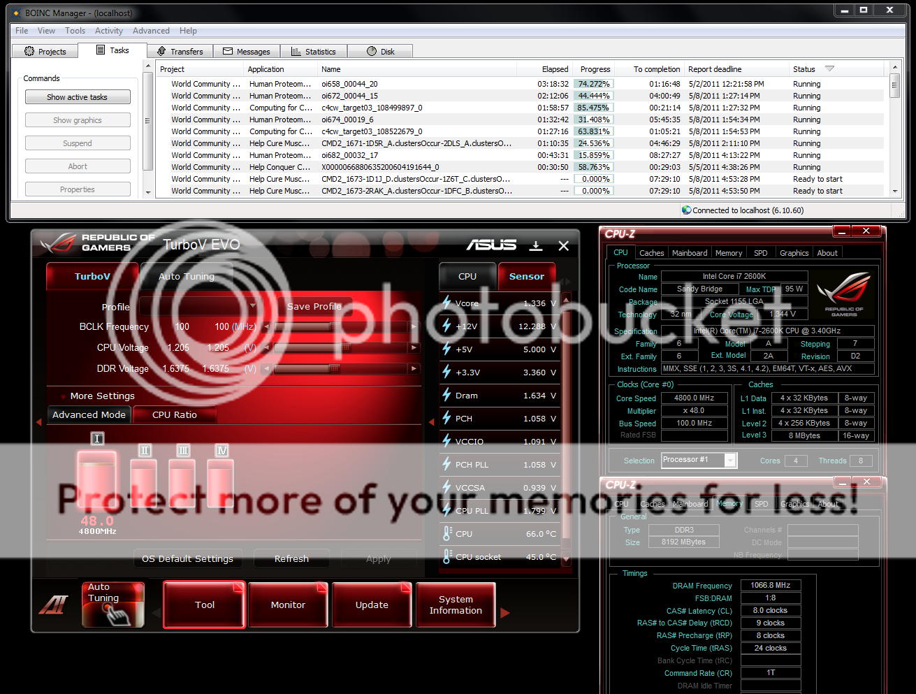

I have been running my b2 2600k @5ghz 1.4vcore. I got the chance to get a b3 board for a great price and jumped on it. Now I can't get stable @ 4.6. Anyone go from a b2 to b3 and have to change settings?
i never heard of MIVE B2 but yes B3 changed normally needed a bit more vcore what bios are u running and what settings
here mine for 5GHz HT 2133 9-10-10-28 1T mem 8GB
all settings on bios
vcore 1,415
vdimm 1,5
vccio 1,08125
vccsa 0,95
pll 1,8
internal PLL disabled (depends on chip)
LLC 75%
VRM 350
C1E and EIST enabled
cheers and hope u get it stable
