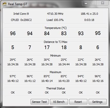

on another note, i haven't done a REAL burst test for temp results yet after lapping. but so far at 4.522, cores 2 and 5 are both almost dead even with the other cores now. core 3 still shows MUCH cooler than the rest by almost 10*c but nothing i've tried has helped that so... ohwell. but overall i'm pleased. i'll be testing temps at 4.710ghz which is so far the highest clock / temps i've had. i will compare temps at this point to what i have pictured in my sig.
EDIT: well 1301 required 1.58125 vcore to be stable at 4.710, unlike 0003 which only needed 1.55625, so these temps are pretty hot, but they are much more even compared to temps seen in my sig regardless of the increase of heat due to the higher voltage. obiously this is not a 24/7 setup, this is also done with ambient temps around roughly 21-22*c. i'm also noticing heat soak is definitely a problem.
Average before lapping w/ 1.55625v = 86-87*c
Average after lapping w/ 1.58125v = 91-92*c
http://i3.photobucket.com/albums/y71/Emobulus/heat.jpg
i'm thinkin of going back to 0003 and seeing if i can touch 4.8ghz at a maximum of 1.58125v. doubtful... but maybe.
