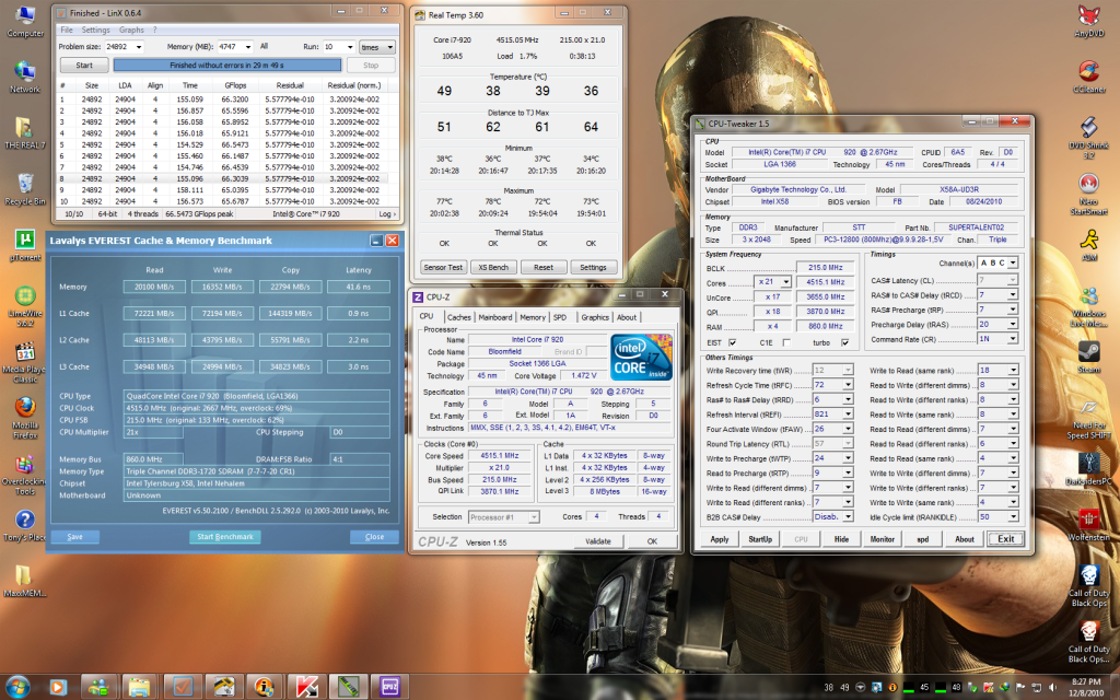

wanted to try out this uncore theory of yours and O C nub . . . just ran a test base linx 10 times then did latency test with some pi , so far not bad ;) going to try to lower timming's tomorrow but im sure that will take a vtt raise Sergio
http://i84.photobucket.com/albums/k7...oreat77720.png
grate my friend you are still runing linx with page file off wich wont let you use ALL mem, believe me its better to do it that way enable page file to any disk and run again if you want true stability
my system is runing awesome fast with CL7 and uncore just need a bump on vtt

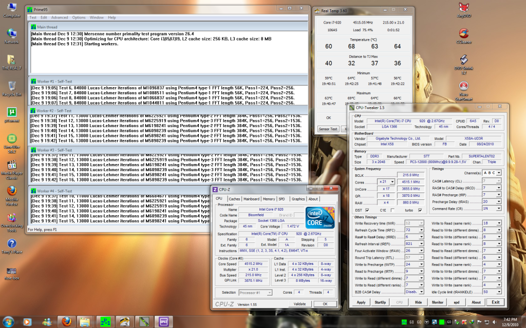

Hey guys look hit x 17 uncore more stable than i can hit x 16 at 4.5 passed new prime 7 hours running cool temps, just amazing like what a little vtt can do :up:
http://i84.photobucket.com/albums/k7...PrimeBlend.png
