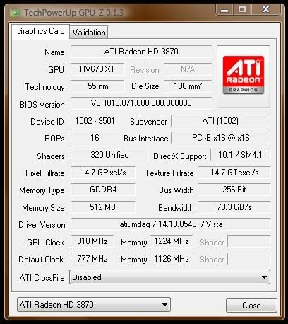

Anyways. Using an MCW60, third component of the loop (follows a Conroe and a P35), I get 40C pretty much continuously with the below settings. 925/1225 was fine by OpenGL_FUR, but UT3 died in just a couple of minutes. 920/1225 seems good so far though, will do more testing soon.
http://img.photobucket.com/albums/v6...n/918x1224.jpg
Ut3 loads cards HARD. I was peaking 3c higher than in cod4 while playing UT3. Is your card vmodded? 918 core is fast!
