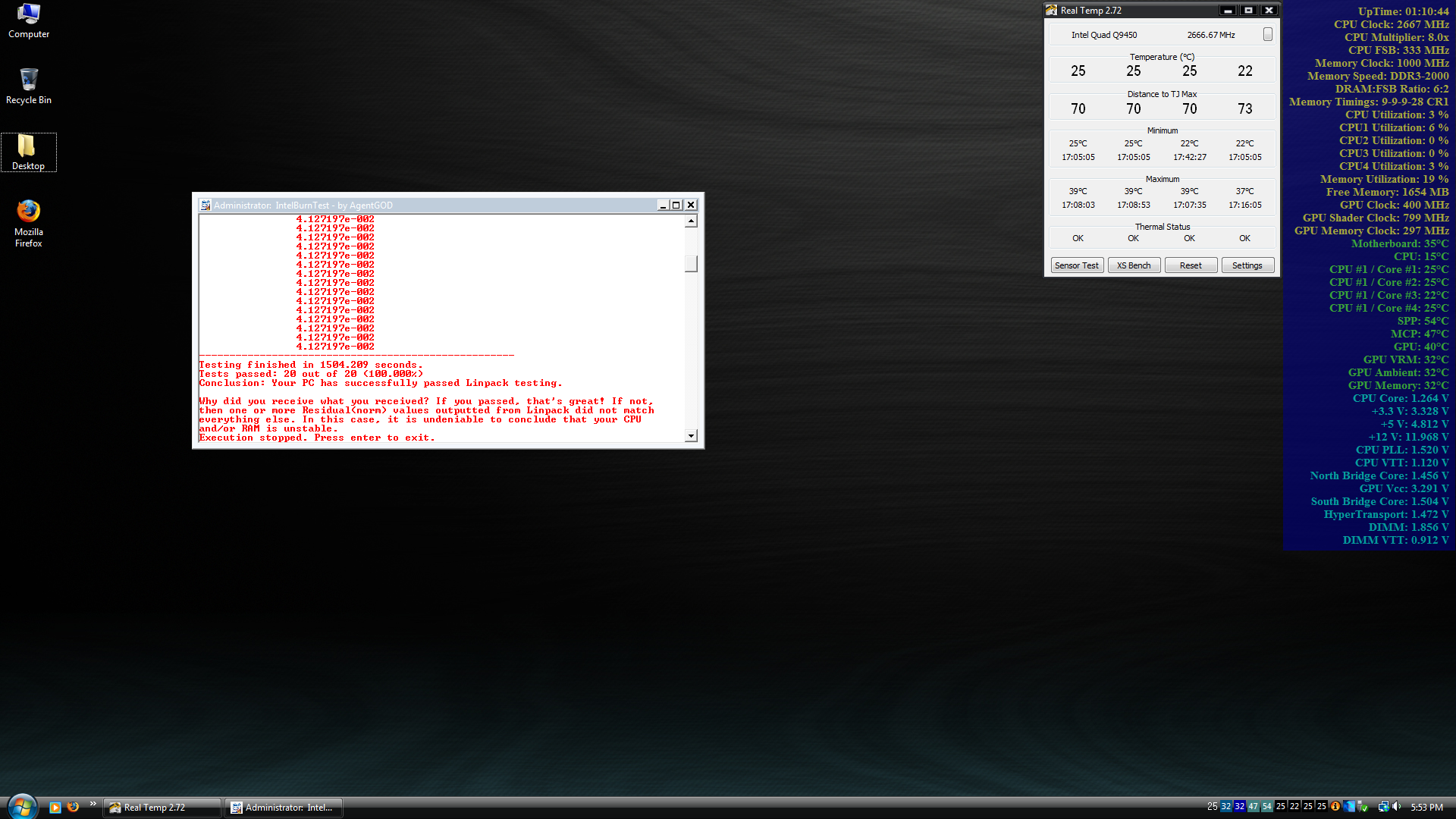

Hi unclewebb!!! i need your help. i have Intel QX9650 cpu with watercooling system and Asus P5E3 Premium mobo. i made all the tests for calibration and i manage to have these calibration settings:
http://img233.imageshack.us/img233/4920/43829284sa1.jpg
http://img233.imageshack.us/img233/4...3cfeefd210.jpg
in this photo core 0 and core 1 is at 35 with ambient temps 31. this is also the report temp from Asus pcprobe program and Everest. the tjMax is 95 that all 45nm cpu's have. but the core 2 and core 3 is 5 degrees more even with the calibration. so i played a litlle with the set tjMax setting and here what i made:
http://img233.imageshack.us/img233/7862/62251112tg1.jpg
http://img233.imageshack.us/img233/7...f133d6f6c7.jpg
i set tjMax to 85 and now all the cores with calibration have the same temps.
is it right to do this? i mean to set the tjMax to 85 and make all cores the same temp?
thank you my friend and congratulations for this great program!!!
regardz
djstx2003
I'm not 100% sure but i think you should leave the TJmax at 95, and make adjustments through your idle values only.
I'll admit that your calibration looks nice but changing TjMax is definitely not the right thing to do.
It is likely that you have a couple of core sensors that are stuck like many other 45nm Quad core owners have. Two or three stuck sensors on a 45nm Quad seems to be pretty typical. You can't use calibration factor corrections or TjMax adjustments to fix a stuck sensor. There's nothing you can do with it to get it to report accurate idle temperatures so step 1 is trying to determine if any of your sensors are stuck.
I'm assuming that you read the documentation and followed the calibration procedure and lowered your core voltage to about 1.10 volts and dropped your frequency to about 2000 MHz for your calibration test. Post a CPU-Z screen shot of that and what RealTemp shows with a 0.0 calibration.
Go back a page to this post and have a look at what I told Xello to do and the information he posted afterward so I could understand his CPU and his sensors better.
ok here a photo with fsb 266 and cpu volt 1.10:
http://img114.imageshack.us/img114/4373/38120961sr4.jpg
http://img114.imageshack.us/img114/4...f6c8620ac1.jpg
also i test the sensors and all is working. i know what is a stuck sensor because this is my second cpu QX9650. the previous i rma it and this is the new.:
http://img98.imageshack.us/img98/581/47632242zc8.jpg
http://img98.imageshack.us/img98/581...6cdee3c5e7.jpg
and finally here a photo from cpu-z:
http://img98.imageshack.us/img98/1038/74371404qd5.jpg
http://img98.imageshack.us/img98/103...69188952b5.jpg
from what i see the core 0 and core 1 have the same temps and the same for the other 2 cores but with 5 more. if i overclock the test sensors readings go higher but i think this is normal.
so now what settings can i have to real temp?
thank you for your fast answers my friend!!!
and here is another photo with calibration at tjMax 95 and fsb 266 and cpu volt 1.10:
http://img329.imageshack.us/img329/9459/57034402cu9.jpg
http://img329.imageshack.us/img329/9...d3f46eed34.jpg
Do you know what your water temp is at idle and how accurate that measurement is? When calibrating with water we need to compare your idle temp to that. With your Quad it's pretty easy to see the two separate Dual Cores inside of it. At idle you should try and use calibration values so they all report the same temp. If your sensors were really screwed up then this might not be possible but I think yours are OK.
Do some more idle testing and confirm 39 39 43 43 and tell me what your water temp is.
After that try running Prime95 small FFTs at default MHz and core voltage or if you usually overclock then run your overclocked settings. I just want to see with no calibration if the reported temps get closer together or not. Most of the 65nm Quads that I've seen typically have core0/core1 that run a few degrees hotter than core2/core3 during a Prime test but yours looks sort of the opposite. Give me some more numbers and I should be able to come up with a suggestion or two. If your room temp is 31C then I think you might be trying to calibrate too low. Your real core temperature might be close to 40C.
The temp number from PcProbe and Everest is probably pretty close but it is not a calibrated value that you can fully depend on to be 100% accurate. My CPU sensor that SpeedFan reports can be off by 10C at times.
For calibration values maybe something like:
0.0 0.0 -2.0 -2.0
might be pretty close. With some more testing numbers I'll see if this makes sense. Post some info from the RealTemp log file like Xello did and make me a happy guy. :) The code /code html tags work great for this.
Hi unclewebb!!! heres what i did. with a digital thermometer i took the water temp and it was at 34. i also put the thermometer up to the waterblock on cpu. there the temp was 35-36. ooh!!! today the ambient temp is 32. more warmer day than yesterday.
and finally i made all the steps you told to another guy Xello and heres the log file:

http://img175.imageshack.us/img175/536/workingfr2.jpg

Hey Unc!
Just loaded up 2.71 yesterday as I was anxious to test the date/time logging. (I'm the one suggested it over @ [H] "nomad8u"). Everything works great except the log. I love the fonts and ProcHot change.
Maybe this log issue I see is by design IDK.
This is how it's logging for me. It looks to be doing 5 date/time logs (set for 180 sec) and then re-logs the same data using just time? I just copied the last several entries out of the log. I shut down Rt and renamed the log and restarted it. It is doing the same thin on this go around.Code:8/14/2008 23:18:00 49 47 46 43

Something is a miss here.
http://i31.photobucket.com/albums/c3.../Untitled9.png
Well, nothing stands out for me. Other than 3 of your cores appear to be reading the same thing at the time of the screenshot. I have no idea what that other program is, so why don't you spell it out.
The other program is everest's OSD on screen function.
OSD = On Screen Display
Yes, I know that Beast. Thank you though. I was referring to the other program, the intel burn test. I've never used it, therefore I can't really read much from it other than it passed.
Oh well in that case i have used it many times in the past few days.
And yeah all it is a run he did and it passed, but i think he is refering to his temps being 25-25-25-22 ... which would be after the test ran .... not sure if it is a calibration issue or not as his MAX was 39C which is weird if he is on Air Cooling, but i can't see anything refering to what cooling he is using as that program makes mine and many others CPU go to 74-80-88C max and i idle at 32-30-28-29.. air cooled read my specs.
We need him to post what he was refering to and as to why he is?
Maybe he noticed that RealTemp reports 25,25,25,22 and Everest reports 25,25,22,25. RealTemp is one of the few programs that re-orders the cores on Quad core processors into there correct physical order based on APIC ID.
Yes, I noticed that on my machine. I changed the order in Everest to match when I saw that.
