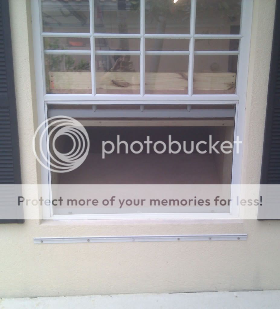

And heres where I plan to install the radiators: The plan is to build a shroud that covers the window and allows me to install the Rads's at like a 45 degree angle or maybe even mount the rads above the opening horizontal (or nearly horizontal.) So any blowing rain doesn't fry the fans. I plan to construct this out of wood, and spray it black. My hope is that the Rads will collect all the heat dump from the CPU's and I can exhaust it right out the window.
http://i399.photobucket.com/albums/p...ect/Window.jpg

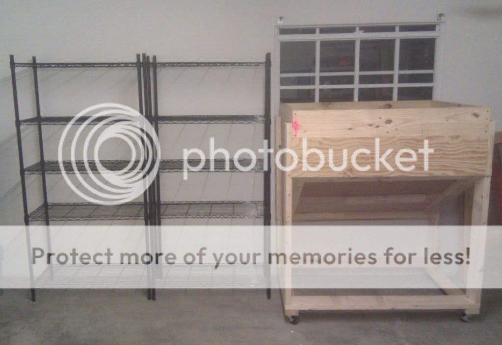

And my new racking: Bought 1 at target today; plan to buy one more. Two side by side for 6' of linear shelfing should give me enough space.
http://i399.photobucket.com/albums/p...t/NewRacks.jpg

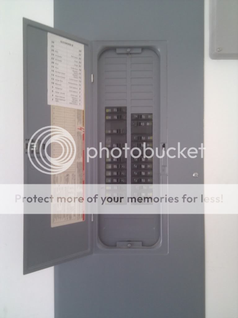

You might have noticed my current problem: in the space there is NO POWER!!! which is a slight setback since i'm looking to run over 10 computers and water cooling gear here... Well on the wall directly across from my future farm is my breaker box, i'm hoping an electrician can run two 240v lines from my breaker box through my attic and down the wall which will give me enough power plus overhead and a couple of percent more efficiency than 120v. Looks like enough free breaker spaces for two 240v lines to my untrained eye :shrug:
http://i399.photobucket.com/albums/p...ct/breaker.jpg

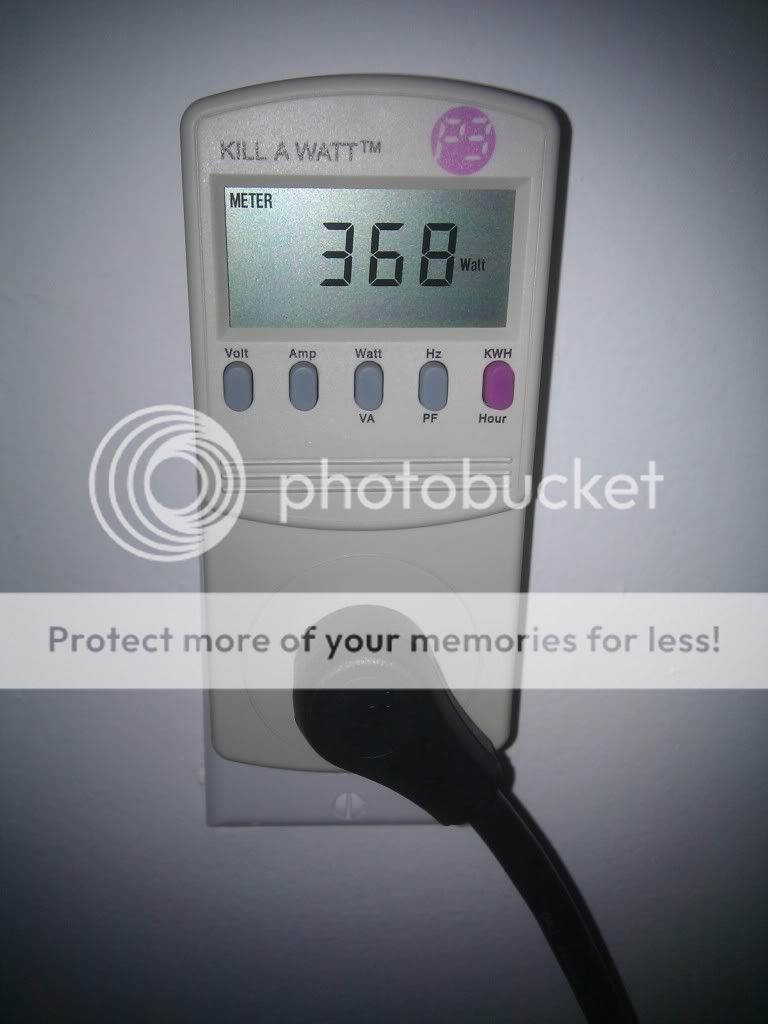

4) I love my Kill-A-Watt... this thing is the best $20 I ever spent, I wish I bought more :) Anyways... heres two OC'd L5640's running off 1 450W UPS, The 4.0GHz 920 I used to have on here was eating 280W!!!
http://i399.photobucket.com/albums/p...t/2-l5640s.jpg

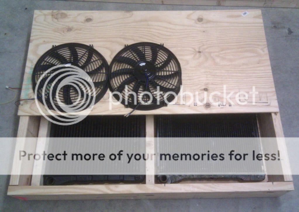

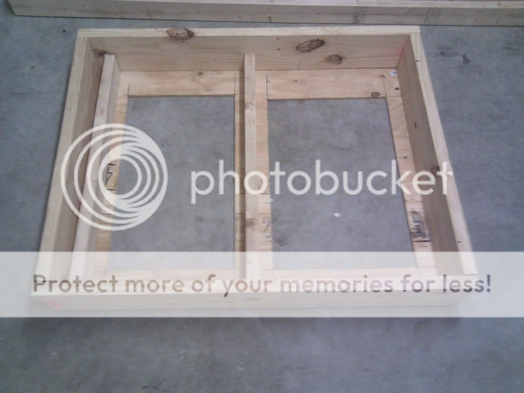

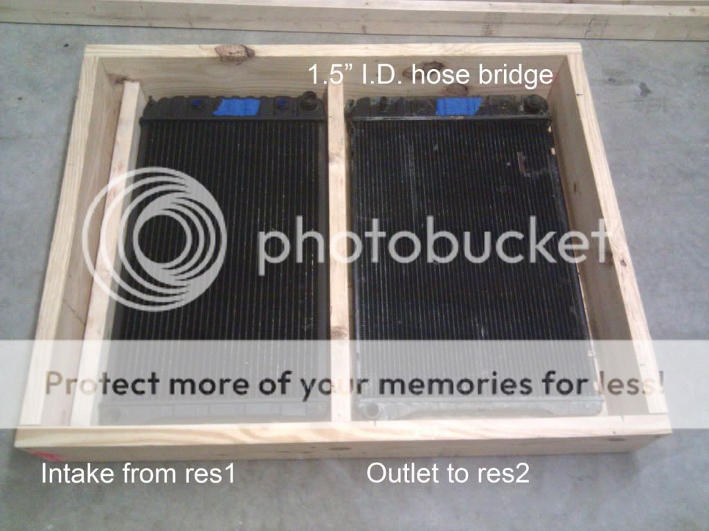

2) Started to build my Radiator housing today, the Radiators are going to be mounted horizontally just like shown; fans will be in the top of the box, and there will be a shroud to exhaust the hot air out the window below the radiators.
http://i399.photobucket.com/albums/p...t/RadFrame.jpg
http://i399.photobucket.com/albums/p...adsinframe.jpg
And this is just for a quickie mockup, the top of the box will be closed, hose holes will be drilled for the connections and fans in the top of the box.
http://i399.photobucket.com/albums/p...dswithFans.jpg

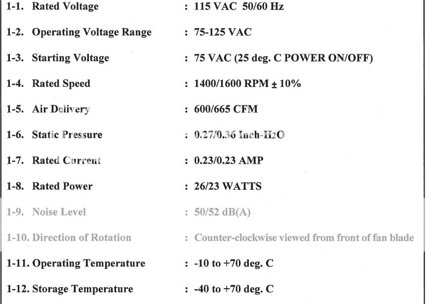

4) These fans I have suck! They are out of the build, I need to find something better. They have high CFM, and since they are in my garage I wasn't worried about the noise, but I just put on on a Kill-a-Watt (let me profess my love for my Kill-a-Watt again :cheer:) 100W at full speed!! for just 1 fan!! and look at the size of my Rads, I need at least 4 so... 400W for fans? No thanks! I'll try some undervolted test on the Kill-a-Watt later to see if they can some how be tamed.

Made good progress on the Radiator holder/window shroud enclosure:
http://i399.photobucket.com/albums/p...tor-holder.jpg

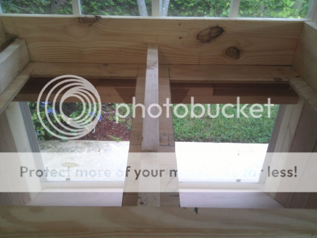

Looking down through the radiator cutouts in the shroud:
http://i399.photobucket.com/albums/p...oughRadBox.jpg
View from outside the window. I plan to paint the interior and any visiable parts black and hang a small curtian or something in the top part of the window. When done the shroud will be very inconspicuous; just a black hole blowing out warm(er) air. Caught a little bit of a self portrait in the window.
http://i399.photobucket.com/albums/p...utsideView.jpg

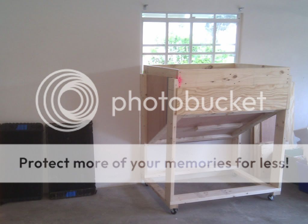

And the rough idea is starting to take shape. Just imagine this with a bunch of computing equipment on the racks and a bunch of hosing and my home made reservoirs and thats the basic idea. The black racks are a bit over 6' tall and each one is 3' wide.
http://i399.photobucket.com/albums/p...ject/Racks.jpg

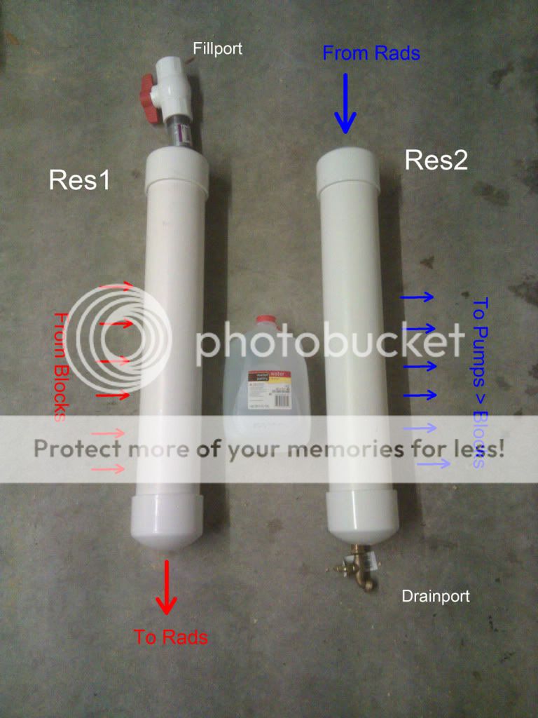

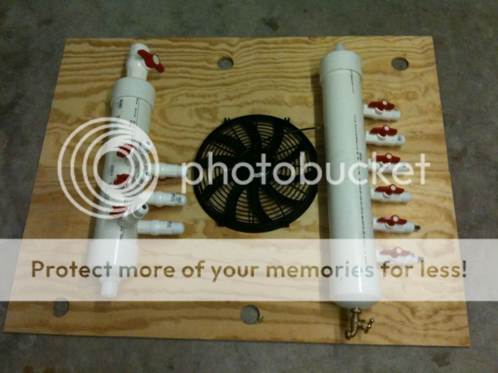

I've made some progress working the last two nights. I got the two reservoirs completed mostly. I still need 10 more barbs (in the mail) and I haven't glued on the endcaps, they are only loosely placed on for the pictures.
The one on the right will collect the hot water returning from the blocks; on the left will be mounted below the Rads and that is were the pumps will hook up to. I have some 655's in the mail.
http://i399.photobucket.com/albums/p.../Plumbing1.jpg

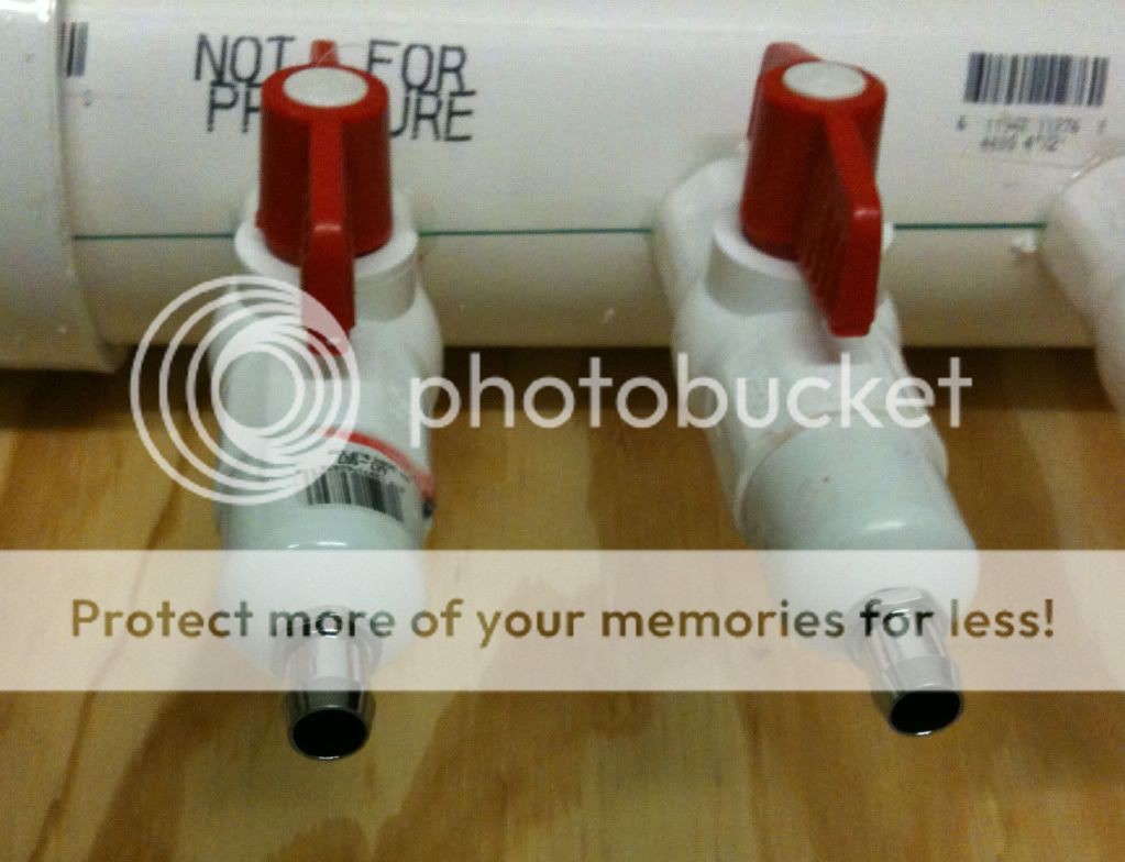

Detail shot of the Barbs, with a half inch hole drilled in the small PVC endcaps they didn't even require gluing. The threads self tap into the PVC and the rubber O-ring completes the seal.
http://i399.photobucket.com/albums/p...ject/barbs.jpg
I've included alot of valves and connections in the system. I spent the last two days PVC cementing, epoxying, and gluing in the hope that the system doesn't leak. I hope to do a test run this weekend, maybe 2 pumps running 2 sub loops of non-overclocked L5640's. I only have two fans until next week, but I can make that run for testing.
